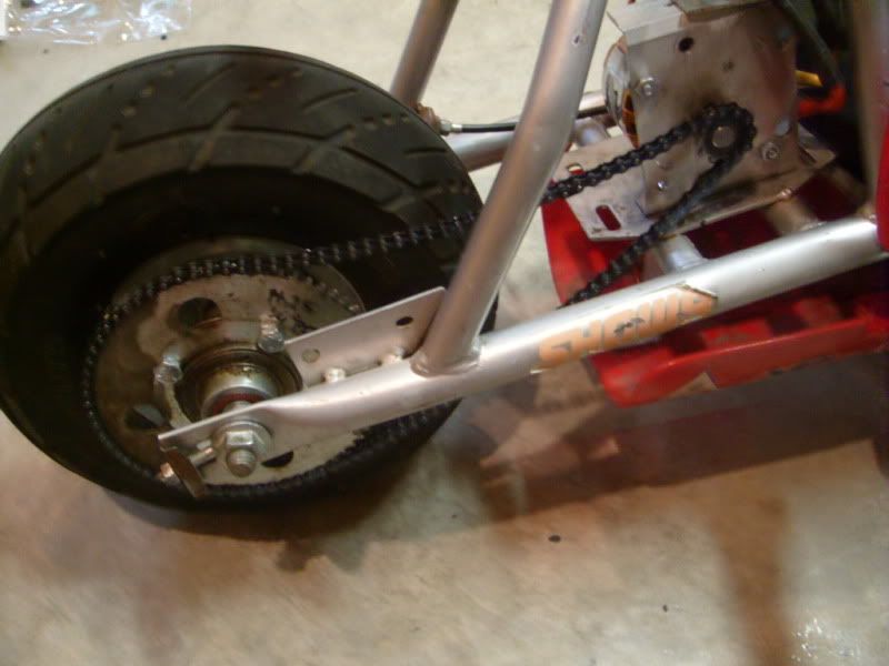

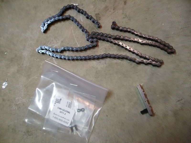

I got my stuff today! Good news and bad news. The good news is that the chain installation went off without a hitch. I measured the length, and hacked the heck out of a link until my master link would work on it. Now the bike has the old electric scooter whiz sound I remember.
Bad news is that the 5k pot I got isn't the right pot.
I re-tested the pot off the servo tester and it is a 20k pot. Is there any way I can make my 5k pot work? Maybe add some resitors or change some settings on the esc?

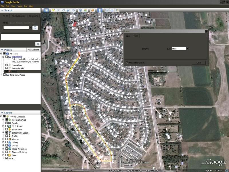

****Performance Report****
I measured out a 1 mile loop. The terraing is extremely smooth asphault. It's ideal conditions minus a little wind. With the 10ah 24v sla pack, I got 5.5 good miles out of it and it died at 5.75 miles. I was able to limp back and finish the 6th mile. Average speed was about 10mph and avaerage mile times were about 5:30-6:00. Temps were about 105 controller, 90 motor, and the batteries were ambient. I don't know what top speed is, but on a fully charged pack it's probably 20-25mph. It seems like it's haulin when you're riding it.

Here is the test route

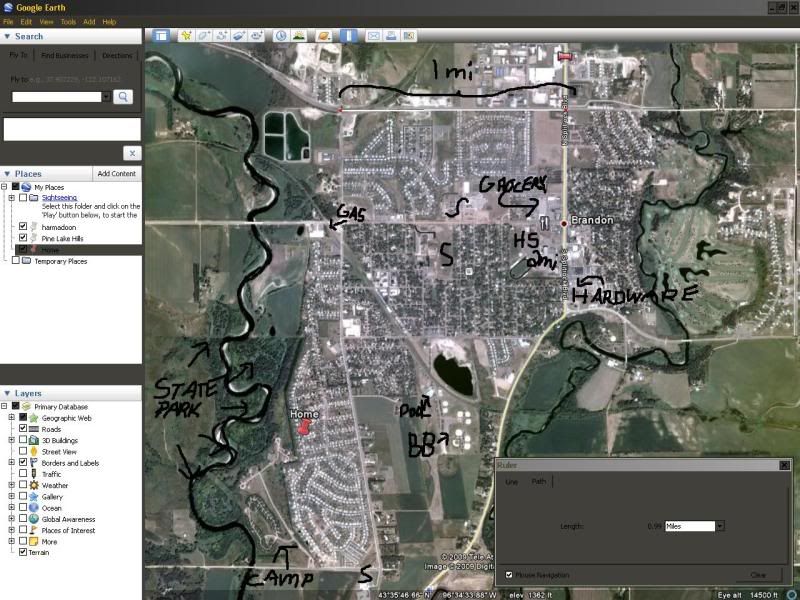

And here is my town. With a 5.5mi range, look at all the places I can go!
