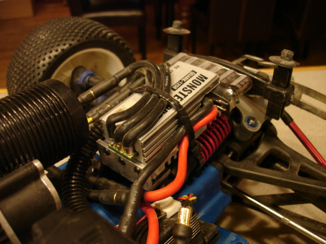

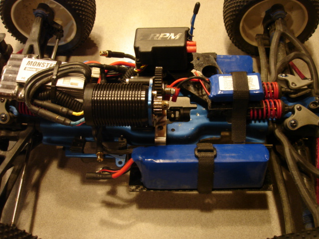

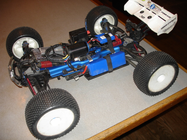

Well, I don't know what you think 'kind' of power an outrunner has, all I know is that an electric motor has watts, and the wattage is a product of speed vs. torque, and every motor has 100% torque at zero rpm and drops from 0rpm to max rpm. I really don't think there is anything different in an outrunner, except for motor inertia (although it's spinning alot slower, so that is near canceled out), it has many times more torque, but spins many times slower, so power ends up being the same as well.
Unless I didn't get the idea you were trying to convey? Explain in more detail?

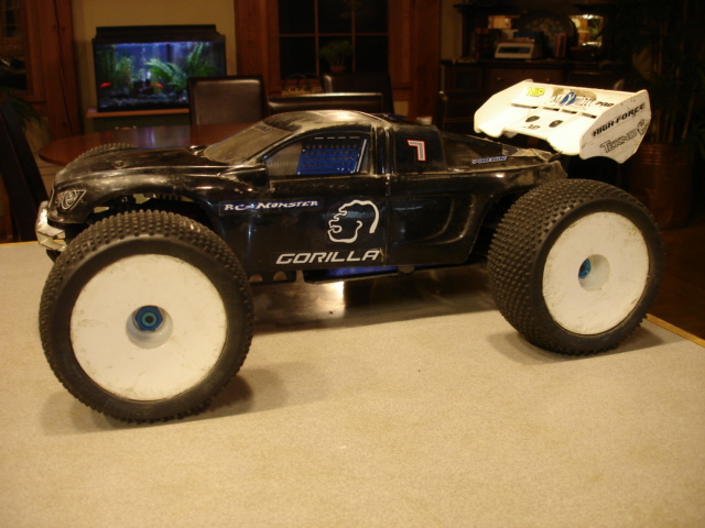

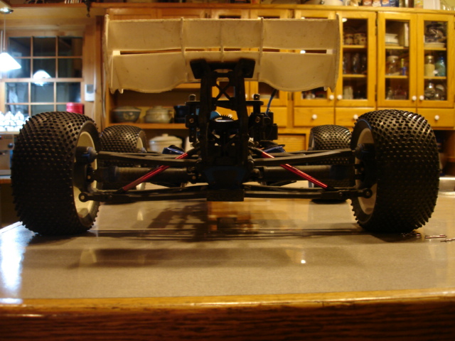

On a side note, I posted some pics of roughly what I was thinking of when I said tilting the trans and making a mount for the motor in the center of the chassis, and lowering it. Check it out. Looks like a pretty balanced setup?
Z-Pinch racer
Posts: 3,141
Location: SK, Canada
08.31.2009, 10:43 PM
The batteries would be mounted on CF angle mounts and will be sitting 1 inch lower than in the picture.

yep, Watts is Watts but could there be something more? LOL
KV versus gearing versus final efficiency rating. I get that.
That's an interesting way to look at tranny position. I like that, but how are you going to secure it?
This should be good.

Isn't there a website that is going to be doing dyno tests for popular motors in R/C? That would put this debate to rest I think, just to see a torque/power curve of some of these motors. Another thought, maybe it's the ESC firmware that is causing a different 'feel' or level of power between a in and outrunner type?
As for the mounting of the transmision, I was thinking about getting a small bracket made that screws into the aluminum plate on the trans and goes around and mounts like the regular plastic stand-offs. I would have to grind the plastic mounts away of course.
