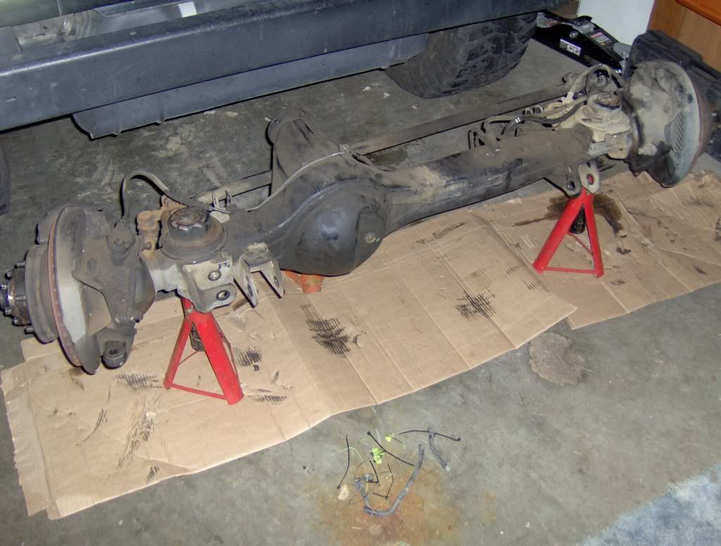

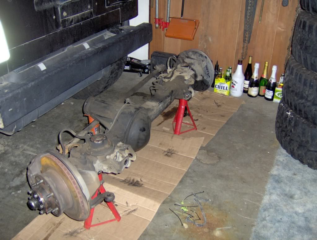

Picked up a '91 FJ80 front axle. 4.10 gears, 63.5" WMS, Hi pinion 8" third member, beefy everything. These are bigger versions of the regular Toyota mini truck axles. They're wider and bigger in all the right places. If I manage to explode the ring and pinions, I'll make a hybrid 80/9.5 axle using a FJ62 center chunk or go to a Dana 60. I think it will be a while before I get to big enough tires to blow apart these things.
I'm planning to run a Dana 300 with cable shifters, twin sticked, coming through the stock Tcase lever location with as little modification as possible. There's a good chance I'll have to have a 1" body lift or make some cuts to the sheetmetal but we'll cross that road when it comes. I know for sure I'll have to reroute my exhaust, get a new rear driveshaft (going with a Toy CV with flange) and get my front driveshaft shortened (possibly not) with a flange adapter. I'd rather keep my front shaft the same length so I can sell it for all TJ owners if I stretch the front. I want to get 2" out of the front and the rest out of the rear to make it 100" wheelbase when I finally longarm this rig.

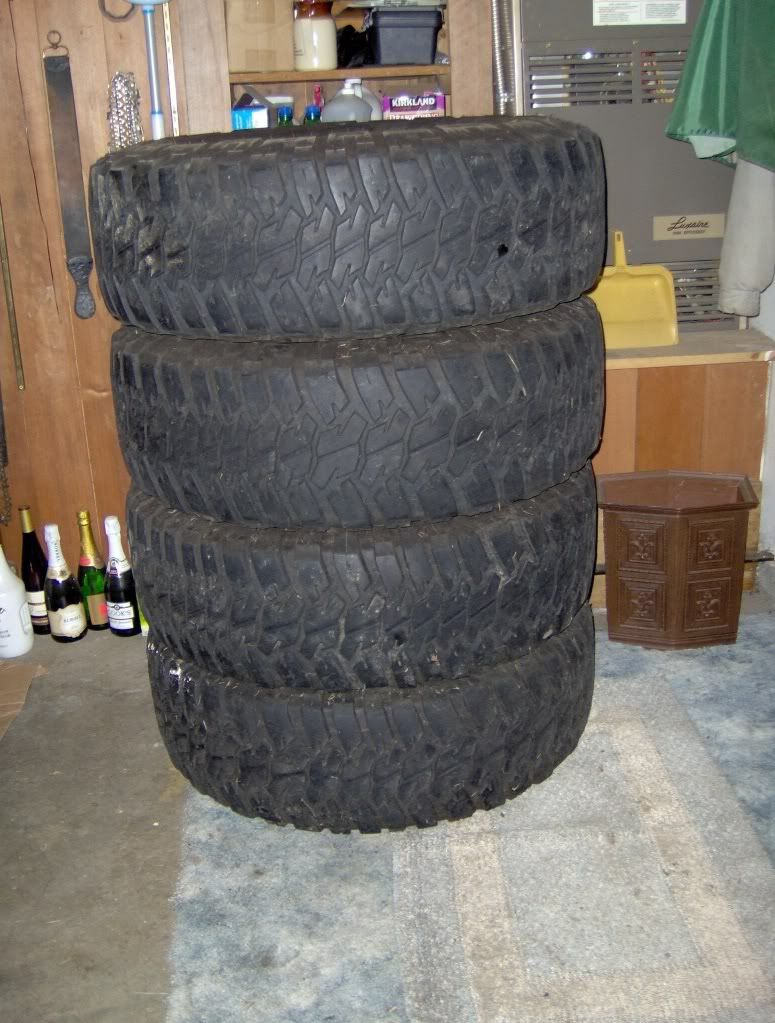

Plans for the rear are one of three options: Zuk 12 bolt rear (cheap but random and doesn't match the front), Tacoma rear, or full float FJ80 rear. The 80 rears are rare and can be expensive. The Taco rears are versatile and plentiful. The 2wd V6 axle shafts are 5 x 4.5 Jeep pattern so I could run those in the back with the HP30 front until I swap in the new front. Then I swap in 4x4 shafts and I'm good to go. Leads me to my next point, which is room to grow. Picked these up for cheap. 37x12.50x17 MTRs at 50%

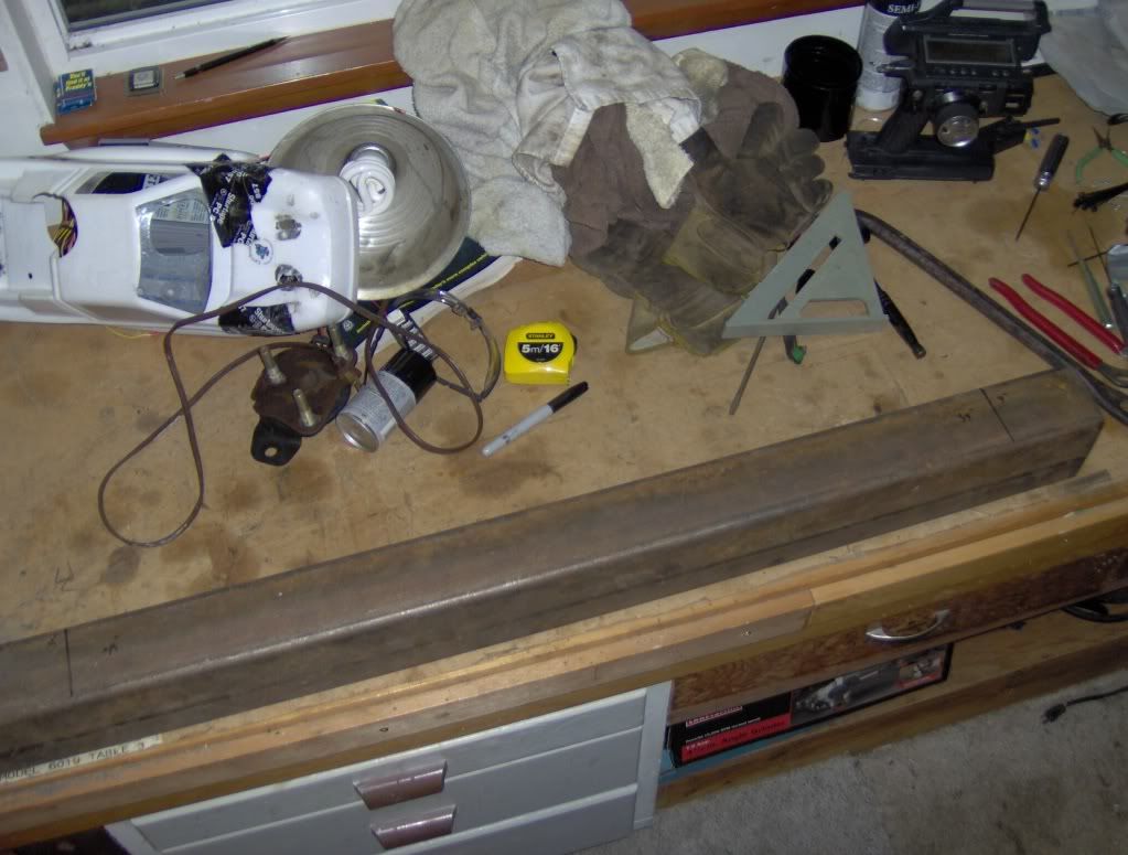

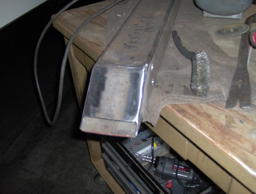

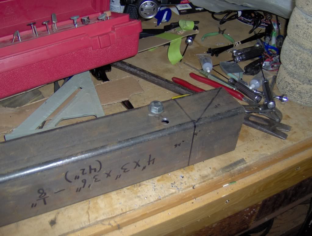

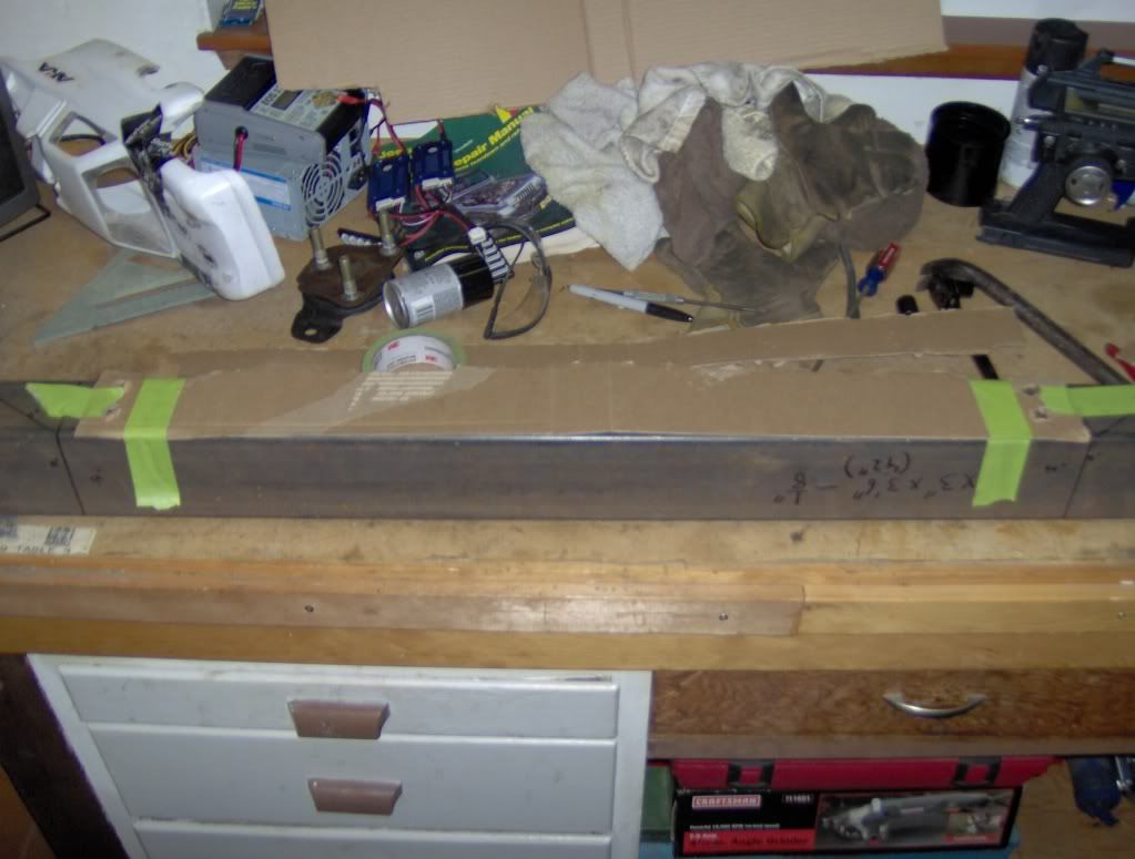

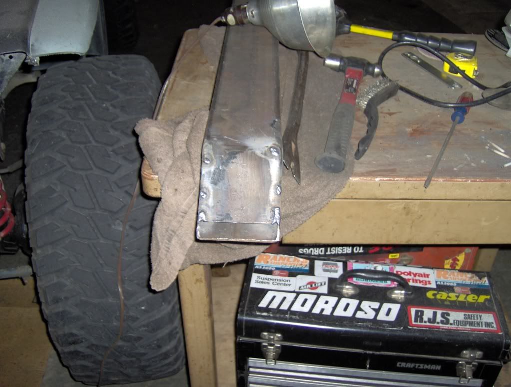

Started on a stubby front bumper that doesn't increase my approach angle. It's merely for protection and deflection purposes, not a permanent solution. It's the first time I've welded something significant with this $100 Lincoln I found on craigslist. It worked pretty good, used 6011 rod and got some good arcs. I'm also using this time to get my welding skills back since I haven't used them in 5 years.
I'll let the pics speak for themselves mostly. If you have any questions, just ask.

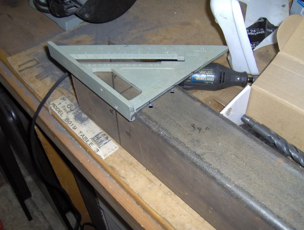

regular stock, 1/8" thick I think. I got it for $5 so whatever
Jig
design
Drill holes, make sure they're square
Drill out for bolts
:D
gtxracer
HOOH HUAH HOOH! Aww Baby!
gtxracer's Avatar
Posts: 868
Location: olyWA
01.06.2010, 06:38 PM

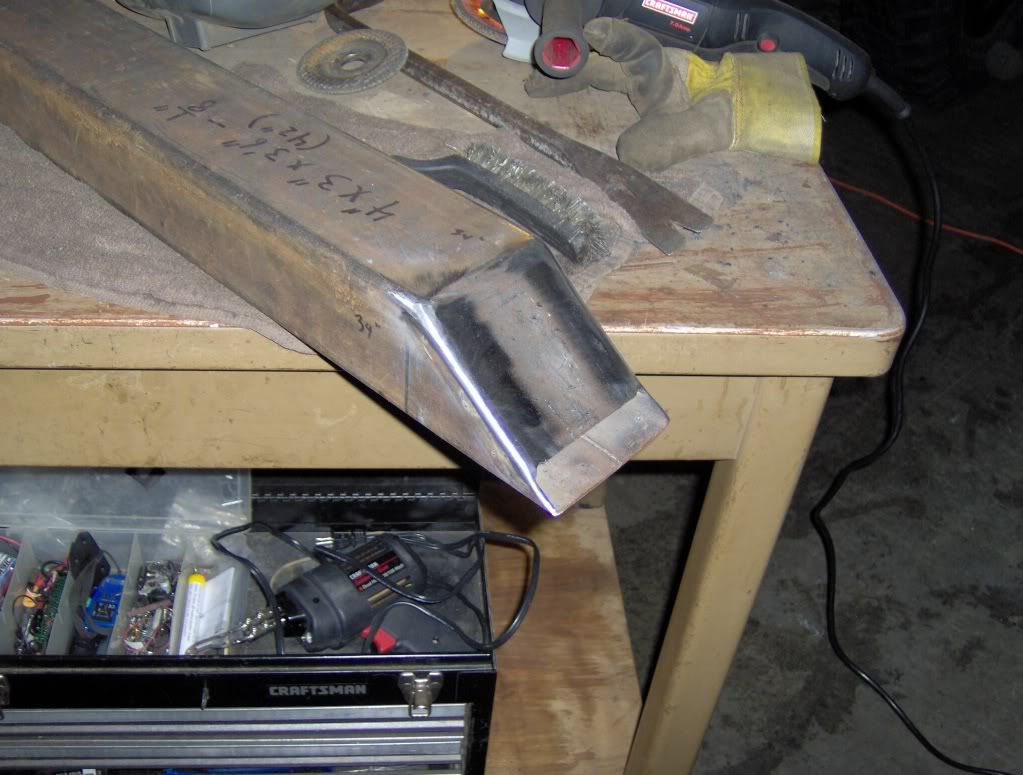

first cut
ready to bend
bent (adding material later)

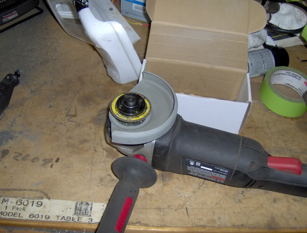

Ran out of cutting wheels so I had to resort to welding

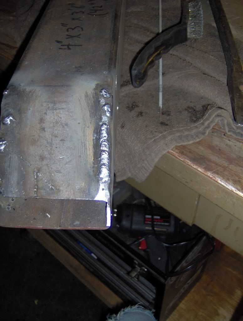

pics of welds, I know there are weld nazis everywhere. It's just a bumper, but I thought this was decent for being rusty. It was a 2nd pass since I didn't like the first one at all. Good penetration and heat. Burned 'em in at 60amps.
Cleaned up, need to add the lower part once I cut out the back of the bumper to fit over the frame. The sides are there to protect the sway bar and hopefully deflect the rig away from whatever I hit. I'm sure if the object is strong enough or I come down with enough force, it will bend or break, but it will do for now.
