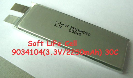

Do you know exact size of single cell (4500mAh pack is 2P)? I am wondering if it is possible to make saddle pack for 1:10 buggy.

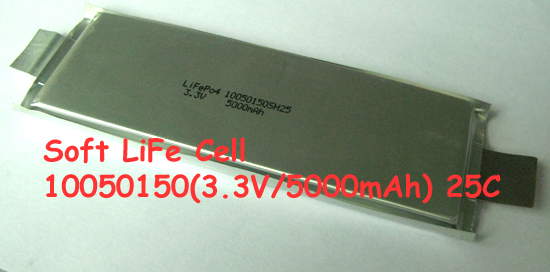

I have attached a picture of what the cell looks like, but you can have it with the leads like the other picture of the 5000mAh. The size of the 2250 cell is: 9mm X 34mm X 104. I have other pictures of the other cells available if you or anyone else would like to see.

These are cells you have access to? How much are they? 2x 5s1p or 6s1p 2250 would be perfect for my HV Savvy. What is the burst? I see A spikes usually in the 65A range, and upto 90A. That's only 40C max.

I have access to basically all the manufacturers of cells in Asia. I haven't asked for price for any of them since I really don't have any interest of having liabilities nightmares incase something goes wrong . I'm in the process of having 2 LiFePo4 cylindrical cells made and it should take around 30 days. One is a 2/3A size for minis and it should have a capacity of 300-500mAh and a Sub-C size one with a capacity of 1200-1400mAh. I can get pricing and MOQ if you want. Also, they'll be fresh cells so it should take around 30 days to get them made.

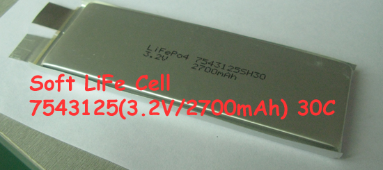

I think you would love the following then. See pics . Should I get them all here and mess with MA a little? I really don't care about making a profit on them and I would just have people sign some paperwork that would clear my name from any wrong doing if they get hurt in any way, shape or form. What do you think?
Edit: The size for the 2700mAh is: 7.5mm X 43mm X 125mm.
