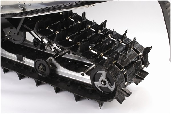

Just for an idea, 2010 Yamaha Apex MTX mountain sled.

Bondo: Yeah, I saw those, as well as the selection here, but don't know if they can take the power and speed of BL.
redshift: Those pics do help. What I want to make won't look that fast, bit it gives me an idea of the rear suspension. To make things simpler, I might not even use a rear suspension, but a lot of that will depend on the track and chassis design.
