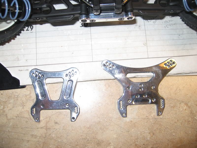

Forward progress continues!.

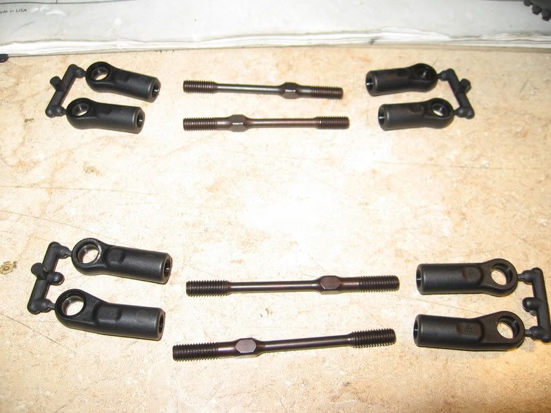

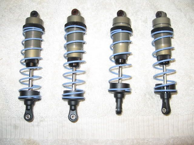

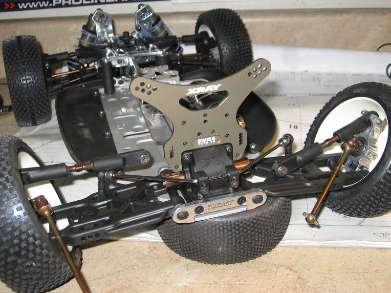

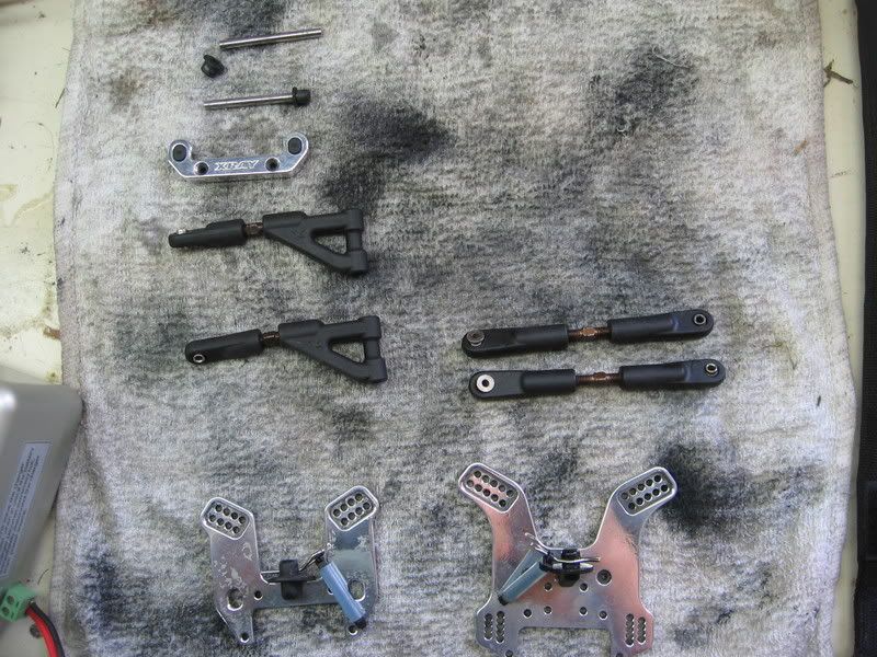

MetalMan has finished up the motor & ESC mount and I'm now have a wild hair up my a$$ to convert this XB8 into an 808, so lets see what does and what does not transfer over.
808 parts that Do fit!
• The front and Rear shocks
• The front and rear shock towers
• The front and rear turn buckles
• Rear lower A-arms
• Rear caster blocks
808 parts that Don’t fit!. (Sure mods are possible, but weren’t considered)
• Front A-arms
• Front caster blocks
• Front steering setup

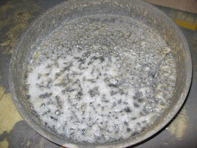

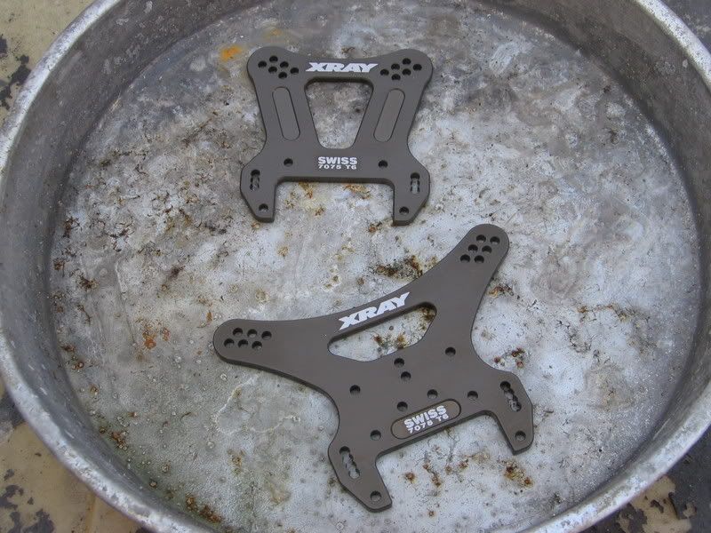

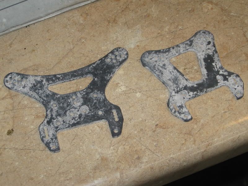

Here’s some work I did that killed me!, I took my new alum aftermarket front and rear shock towers for my 808, striped them and polished them up, I’ve got to stick with the “Bling” theme. I was actually contemplating striping down the shocks and polishing them up, but that’s just taking things too far at this point. That should happen once I’ve purchased a proper motor (1512 2.5 Ds) then I’ll probably and strip them both down & polish them all up @ once!. Achieving the ultimate Bling.. HHHhhaaaa hhaaaa..
So here is a shoot of all original parts removed, these will be saved in a plastic bag for possible use in the future. I wish I had a scale!, all of these parts I'm guessing equal well over a pound.

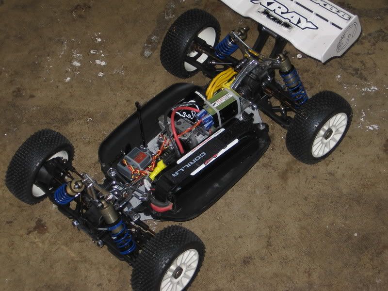

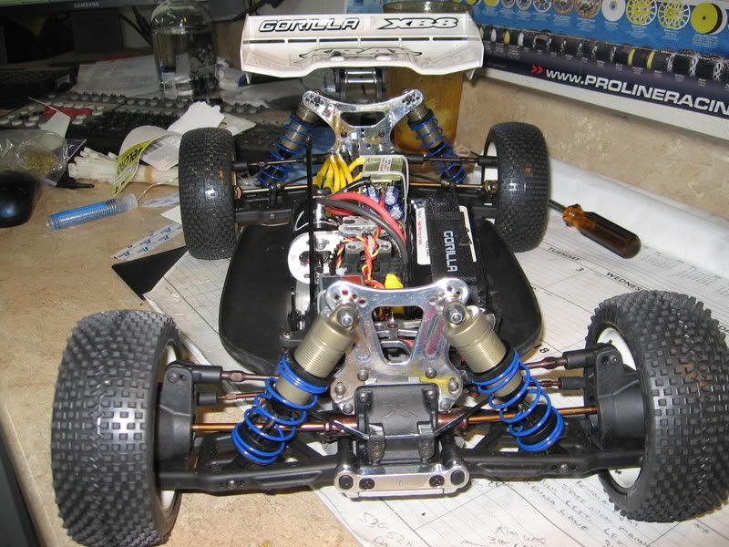

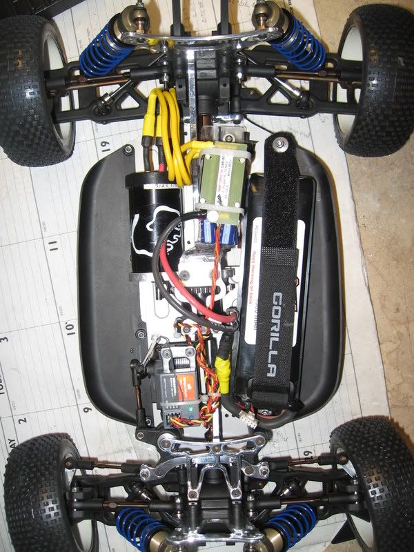

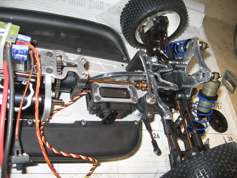

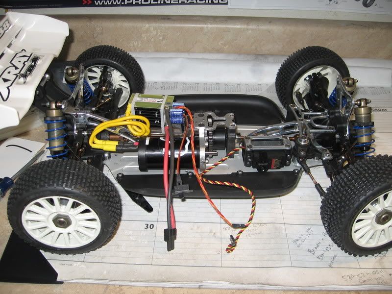

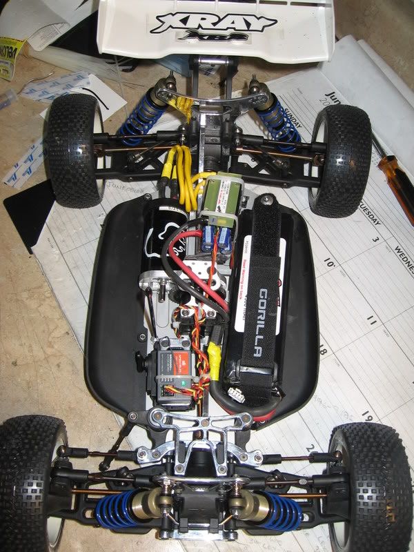

So here we have the buggy coming together, we are now installing the MGM and (per MetalMan recommendation) I did not purchase a JR servo, I got a Hitec HS-5955TG

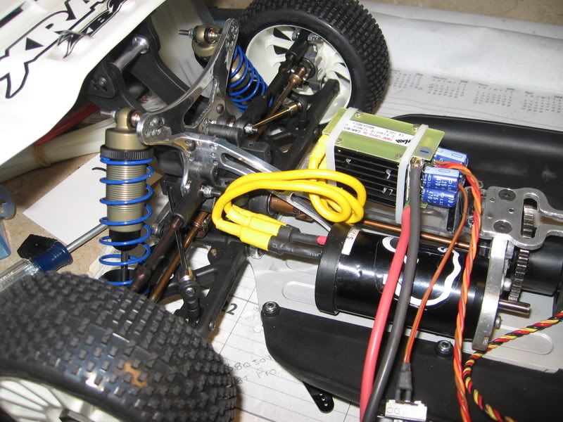

Now we are in the home stretch, I'm completed the installation of the battery tray & battery strap, installed the RX & antenna and have buttoned up all of the wiring. Hay its starting to look like a buggy now (finally)..

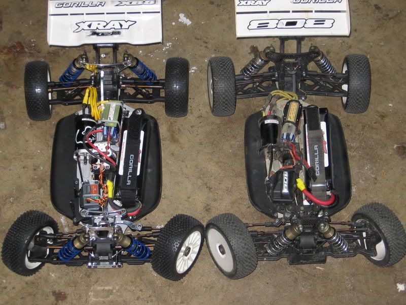

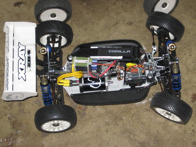

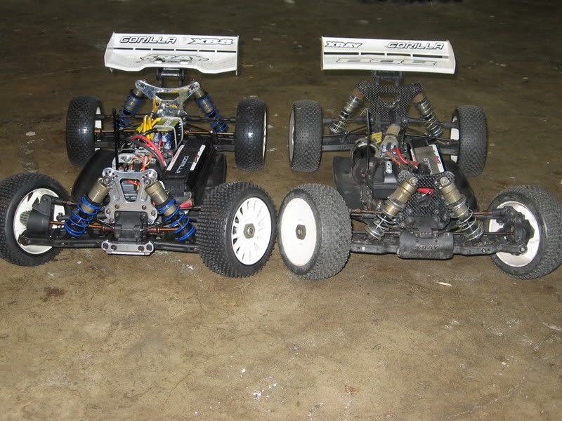

And here we have the completed product (although un tested at this point) side by side with a 808 for a final comparison, I think it when it all said and done, the conversion was a success, I was able to remove some extremely heavy stock pieces and install lighter, stronger and more responsive parts in there place.
The best part of this is now I can actually test the following:
• Suspension adjustments (camber, toe, droop, etc),
• Motors / everything from a 1509 1.5y to 1515 3D) temps and time..
• Gearing / Spur gears rage from 41 – 46 T, pinion range from 11 – 20 T
• Shock & diff oils, (20 – 50 / 2k – 6k)
• Proper center of gravity / weight distribution (front / rear and left / right)
etc on extremely similar buggies in weight and (e) supply. I'm running both on MGM so that a given (there I can test for free wheeling, braking, timing, etc) plus they are both using a Polly Quest 4s 30C 4500mAH for their power requirements.

Looks good ! How's the ESC mount with the standoff in place? Just keep in mind I am totally willing to re-do the ESC mount and make it better, if this one doesn't hold up as well as your 808's mount does.
Also, any first impressions on the 5955-TG?
