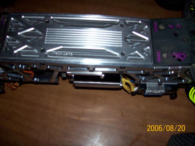

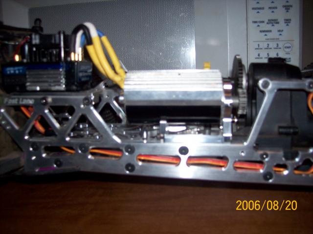

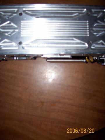

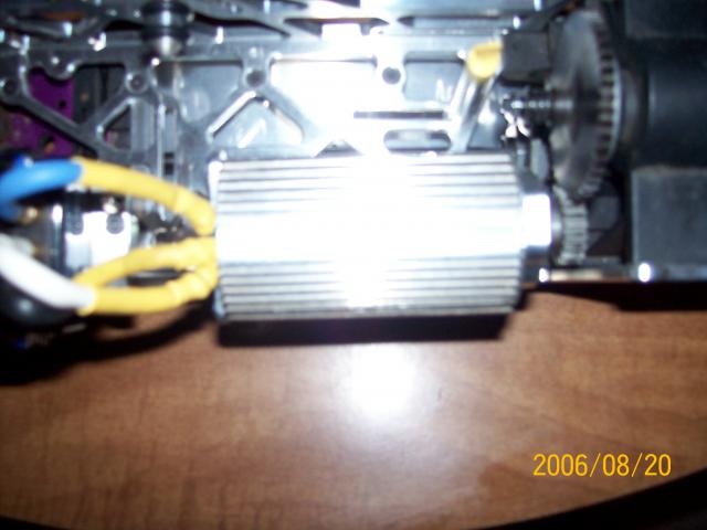

The more i look at the last photo i see you problem you have the motor sitting in the wrong place. i'm not sure how it fits in a flux but the pinion doesn't sit that low in my truck, it really sits off the side of the truck even with the 44spur it don't look as if i could have a tvp wall on that side. pics blow but you can see how they keep the motor plate off the drivetrain.
EDIT !!!
swap the tvps then cut the rail out on motor side use the flux motor plate and mounts, run the integy roll bar that mounts from tranny to rear shock tower (i can't wait to get on or make one their stupid simple and works great) but this would keep things stiff and rigged.

http://www.hpisavageforum.com/forums...ad.php?t=12117
I may move the entire motor plate down, below the driveshaft... I dont know if it will work, but it may..
If not- i need to cut more from the chassis.

Before I decided I was going to do a 4ws setup, I was trying to do what you are doing with the XL chassis. I wanted to reuse my nitro revo motor mount and mount it on a skid plate which would be attached to the chassis braces. I few pita's as I remember:
The motor does sit that low, but as pic'd, its not elevated on a mount yet. Depending on the mount, it may have to sit higher, and maybe further out the TVPs (depends on gearing.)
The motor mount would sit close to the tranny. forget about getting to the motor's front screws to adj mesh. You need a mount that can slide sideways like a nitro mount. If you mount it on a plate and low to driveshaft, care has taken to get/make a narrow mount so it won't hit the axle. The chassis braces can kinda get in the way too (at least if I wanted to reuse my Revo mount using bottom mounted screws.)
Overall, it was hard to find a way to keep a 15 series inside the TVPs.
In the end, I decided to just go w/ a KD mount. For $20, it was far easier to do than making custom mounts and plates and BS. Also, it allowed me to tuck the esc and servo underneath and keep safe, altho at the expense of a high mounted motor.

I had to grind the Tvp around the transmission and cut peices off to get the motor to fit..
Pics later
