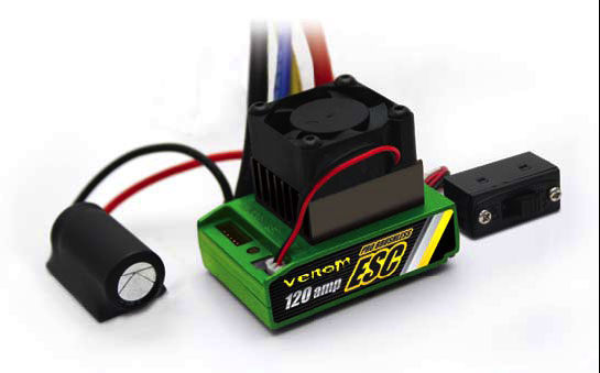

Hey guys just wondering if you reckon a Venom 120A (Xerun style) would run my Medusa 3300kv 50mm motor in my Hyper SC
the cheapo Aeolian I have doesn't let me disable the LVC so won't handle my Lifepo4's
I know the VXL ran it happily with the LVC turned off.

What if you put the Aeolian esc in Nimh mode?
I'm running the MMpro on 6s a123 in my extended rustler now with a 1512 1400kv motor. The setup runs cold. ....forgot about your signature.
The Tekin can do it as well.

The aeolian doesn't have a Nimh mode, that's my problem!

Yeah, the XeRun will run the Medusa fine. You can put in lower LVCs or NiMH mode. Or, with the LCD program card, you can custom set the LVC.
