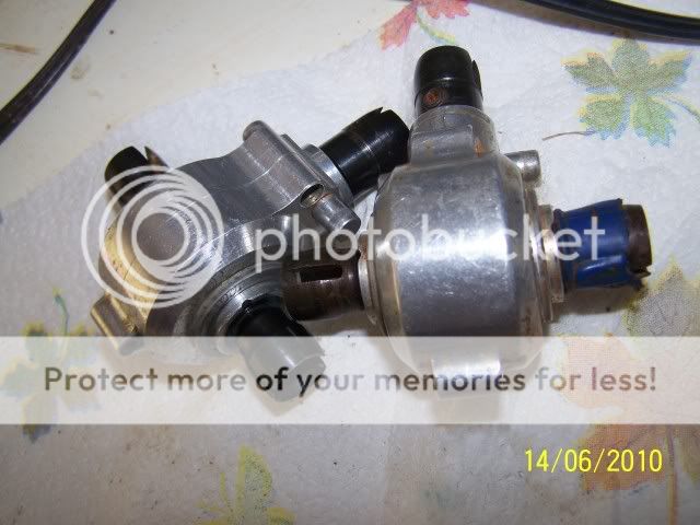

Yep those are pretty cool. I have the truck back together after the huge rebuild. Its great. All new Avid bearing. Finally all of Jacob's Proline Powerstrokes are on. I plan to bash them 2day or 2moro but regardless at the end of the week I'm going to probably empty them and add some 60wt oil. I haven't figured out how I'm going to clean them completely any suggestions? I can't remember how I've done this in the past. I got my arms and bracing done, made a new CD top plate out of FullForce CF, switched completely to a one battery setup with my 4s Hyperion next month I'll order a 6500 4s pack so I can run 25 minute mains, and moved my ESC and cleaned up the wiring a bit.
Jacob, the diffs where doing great! Infact I opened the rear one up just to peak and it was missing a tooth but running fine. I finally got my UE 8spider diffs fixed so I'll take them out at the end of the week and put the UE Ultralites back in.

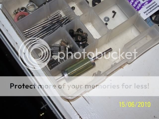

Is this a good place to keep my extra rotor?
Thanks,

THe CD had 10k in it, as far as cleaning the shocks I use an air compressor and a 2" paint brush with the bristles cut down so they are stiffer. I cant believe those diffs held out that long, I put them in there originally just to get her going and use it. After a few packs they were still together so i said screw it and left them in.

I clean my shocks with an old toothbrush, soap (Dawn) & water, and twisting a soapy wet paper towel down inside the shock body to get out the gunk/oil in the very bottom.

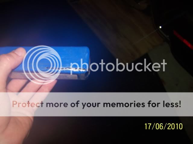

Thanks guys. Yep it has cost me a pretty penny and alot of hard work and research but I've finally got my Maxx up to 1/8th scale specs.
Its soo bad.
The battery still seems fine. No puffing, no heat, good voltage even underload. What to do?

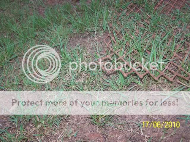

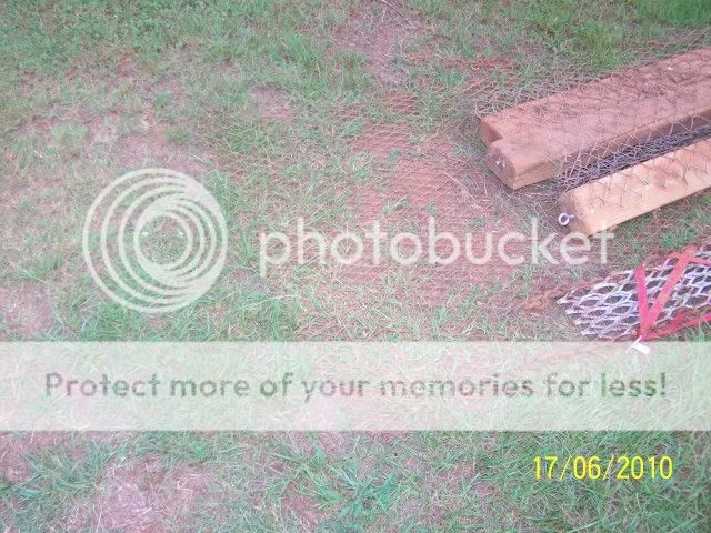

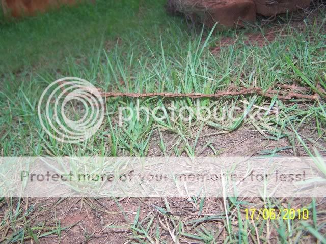

IS that in your garden or a public park? I'd find/ make some U shaped pegs and nail that crap to the ground, or move it somewhere safer.

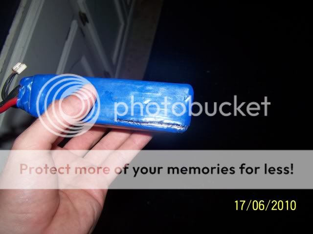

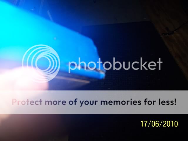

Is the silver foil on the cell damaged or ripped at all, or just the blue shrink?
  (#473)
Kcaz25
Kcaz25's Avatar
Posts: 1,419
Join Date: Dec 2008
Location: Louisville, KY
06.18.2010, 06:25 PM
Its a drag for a public BMX track. It smooths and grades the bumps out when being dragged by a tractor or 4wheeler. It could cut an ankle to the bone. Its quite pernicious. I thought I would be more down about it, but after hearing it and figuring out what happened when I saw it, I was like of course. I got in the truck and called it a day, no screaming or swearing. I was impressed.
Yes, it is quite deep I was afraid the pics would not do it justice. Its into the foil. I expected some kind of sign like some puffing or smoke or flames but these Hyperions are pretty tough. What is the next step? It really want(ed) to run it I've done alot to. It was an experimental run, the first time for some mods. For instance all 8 Power Stroke's maiden voyage. Please tell me I can run it! lol

I just checked voltage, I got 4.05, 4.05, 4.04, 2.35. Not good. You guys are going to tell me to make a 3s pack, aren't you? Not good. lol
  (#475)
06.18.2010, 06:52 PM
If the damaged cell is reading 2.35v... yep, 3s pack time.

What can I do with a 3s pack? Its not even any good for my buddy truck. LOL suggestions?

Sell it (might not get too much, but it's better than not using it at all) and apply the money towards that 4S 6500mah pack you want to get.

Simplechamp that sounds like the thing to do. I took the damaged cell out and placed it in a tub of salt water. That was fun, lots of bubbles and what looked to be underwater smoke, yet the water never got warm. This went on for about an hour. To be safe I'll leave it in there for two weeks.
