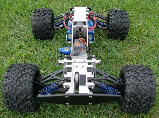

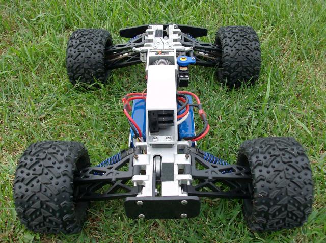

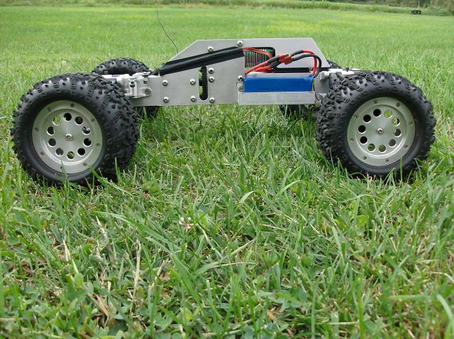

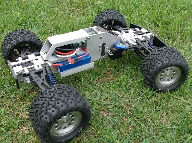

Ok been a few days, here's the beast in all it's non-glory.
I noticed after a few runs the two screws holding the shock lower mounts getting loose. So I made some additional pinch plates, just tapped the mounts vertical. And the little plates double as protection for that area of the A-arm. Also made some ultra-cheesy bumpers and a 'roof' to protect those vital components. On my third run tonight I managed to flip it on pavement and dug up a corner of that pretty good, so very happy that protection was in place! That's why we get pictures first
Three runs with the new steering and it's working well. I'm running a single servo, (my second is in for surgery) so it's not up to full potential.
Now on to the shape... um, yeah. It's looking more like an AMC product, that's not good..
Seriously, I have picked better looking crap off the bottom of my shoe.
It's gonna take nothing short of a miracle to come up with a cool body-type thing.
But the performance is there, absolutely thrilled with the handling. COG is quite low even with the motor top-mounted. I was gonna mention in an earlier post, I know it must be weird seeing Muggy arms without fist-sized shocks on them... but I'm not really big into jumping. I'm after a good handling platform with excellent climb-ability. If I wanna get big air I throw a plane up The shock setup I compared to a Revo only in the respect that it "paws" over stuff much like a Revo. But this setup doesn't have the Revo's progressiveness, obviously. The preload can still be increased some before I hit spring cramp. So even with some additional body weight I think I'm well covered. I did a one foot drop test with my buddy's 3905 which is slightly tubby with a cage, etc. and mine fared better. Not that I'm even worried about bottoming out with this chassis..
ID:	9275   Click image for larger version
ID:	9276   Click image for larger version
