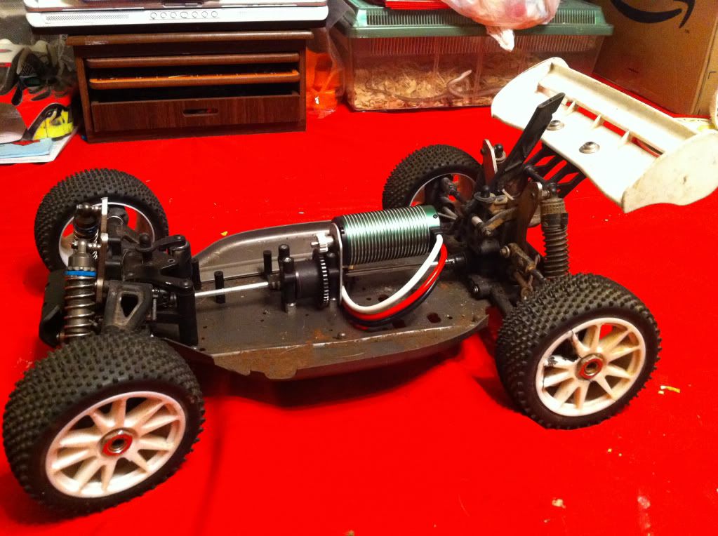

OK, a quick update. I've made a few purchases to add to the 1518, still on budget but I've had to add a second round of buying for a later date.
So I've got the 1518, ordered a pair of turnigy 4s 40c 5000mah lipo's (to be ran in parallel for the time being), a set of dirt tires, a MMM, a Savox titanium ultra speed servo, a mod 1 16t pinion, a mod 1 14t pinion, and a pair of losi battery trays.
I fabbed up a quick and dirty motor mount plate that screws to the original diff bracket so I can play when the parts are all here (no jumping or hard core bashing with it).

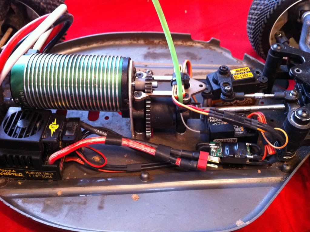

Well at this point I've patched the buggy togeather so that I could run it just to test the electronics. I found that the Savox ultra speed servo pulled way to much current from the MMM BEC circuit resulting in shut downs. So I grabbed my CC BEC and wired it in (still need to shrink wrap it again) to power just the servo. Works like a charm, this servo is really impressive on 6 volts with enough amperage to feed the beast.
I'm still planning on flipping the motor around and locating the CD at the back of the buggy but untill the RCM universal diff/motor mounts are back in stock it'll be in this layout. I think the steering servo can remain in it's location from here on out.

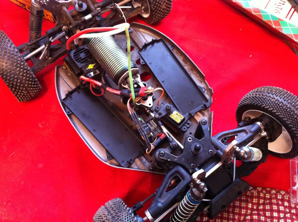

I hope the lipos will show up tomarrow (day #7 of USPS 1-3 day priority mail) so that I can start mounting the trays and experience this rig on 4S. I did my testing with a 2S maxcrapp that was salvaged from a 3S pack (4 months old and they wouldn't warantee it because I cut it open to isolate the bad cell and save the rest of the pack...)
So far I like the layout with all the stuff centered in the chassis, the motor is high above the chassis plate but I think it's a good compromise to be able to run a pair of large lipo's for power and run time. Can't wait to get the lipo's installed and running.
Here's a pic of what it should look like with the trays installed.

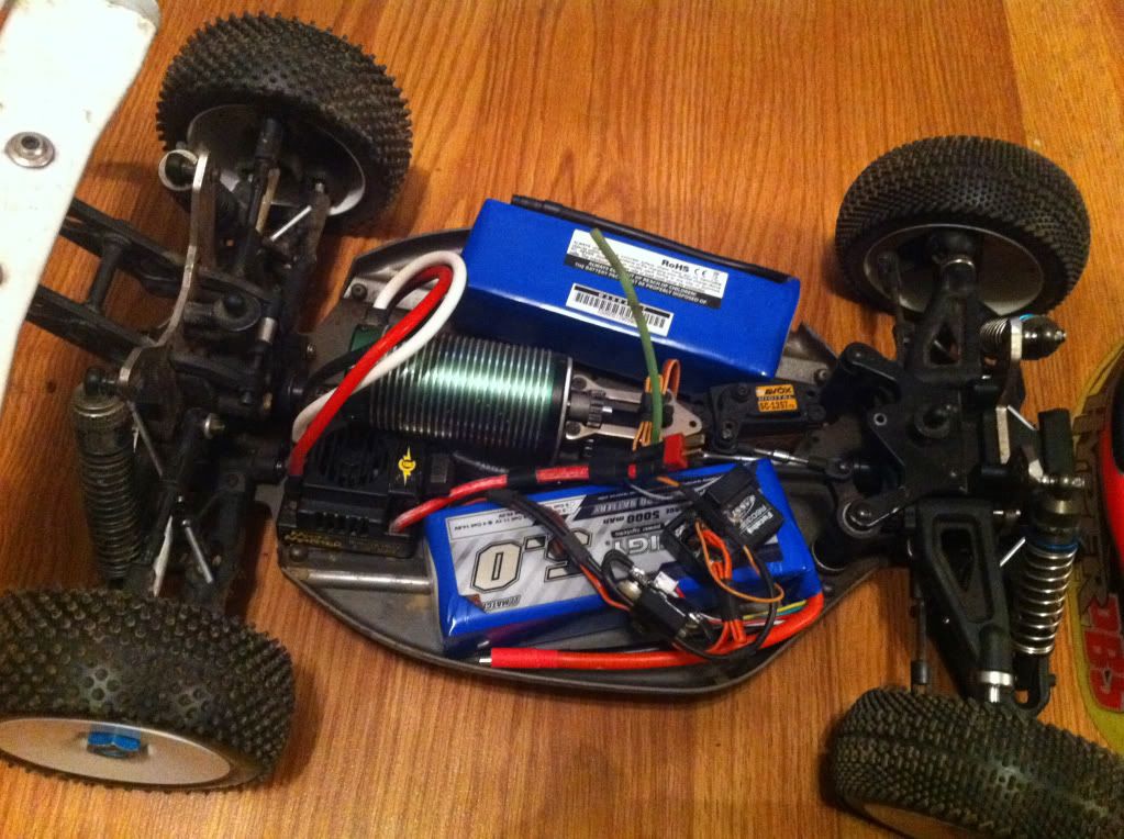

Batteries showed up today and I found a critical flaw. I did all my measurements by the pack size, not accounting for the 8 gauge wires. The wires basically make the packs about 12mm wider on one end :-( that means I've got to relocate my radio and BEC.
I think the jist is that the Mamba XL and the diff relocation need to happen sooner than I had planned. I do see that the XL is on the castle sight now, but still no word on when the mount will be back in stock.
Here's a pic of the batteries in the chassis, not mounted but just for reference.
