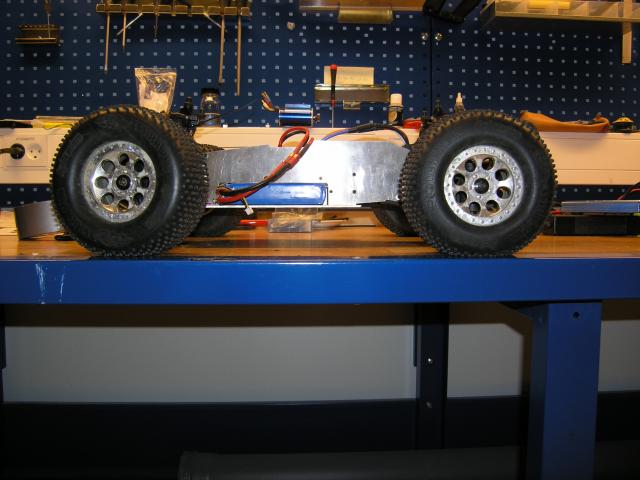

this is such an awesome setup! I love it! As long as you can maintain enough structural rigidity and lose enough weight, this will handle so well for a savage!!!
I wish my current build, utilised a similar setup!
You now have plenty of space to mount things above the lipos! Maybe even a large 12s ESC ;) and have the battery slots large enough to take a 4-5s lipo each ;) And a huge motor in the rear haha
Anyway loving it!

Took the G-Savage for a test run and it handles MUCH better than it did last year!! :)
Since I havent balanced the new wheel/rim bombo I ran the old terra pins... still feels a little like driving an elephant on stilts at high speeds - but much less than last year! Im hoping the Mashers will perform better due to the lower side wall (and taping).
Turning radius is absolutely great (tho I dont really understand why a CD help in this area? This was especially noticeable when I let got of the gas and turned at reasonable speeds the truck would turn on a dime! Sweet :)
Will have to play with CD oil... couldn't make the damn thing wheelie no matter what I did! Need to find the golden optimum between handling and MT behaviour!
Will update with some pictures once wireing is done nicely :)
And I still have to figure out how to secure the bats... strapping tape around the TVP's doesn't look good at all... but it works ;)

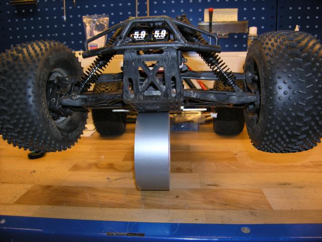

A quick picture of the fatty's ground clearance with Terra pins. I put 1½cm of fuel tube inside the shocks in order to get horizontal "arms"
Here they are:
Thus I have an "on-road" as well as an "off-road" shock set :)
The truck weights in at 6,5kg (14,33 pounds) with the 1717, terra pins and 2 x 5800mAh Turnigys

Looks good Nixpus! I do like how you did the batteries, was thinking of the same thing if I redo my Savage 5T conversion.

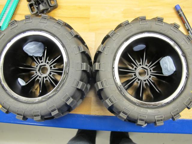

I used taggy wax. Pretty straight forward... but it doesn't look super pro!
Truck with Mashers look better than with Terra pins:
Swapping CD oil later and checking high speed handling :)

That wax looks like blu-tac which is what i use. It ain't pretty but it's fast, easy and doesn't go anywhere once you get it on there.
