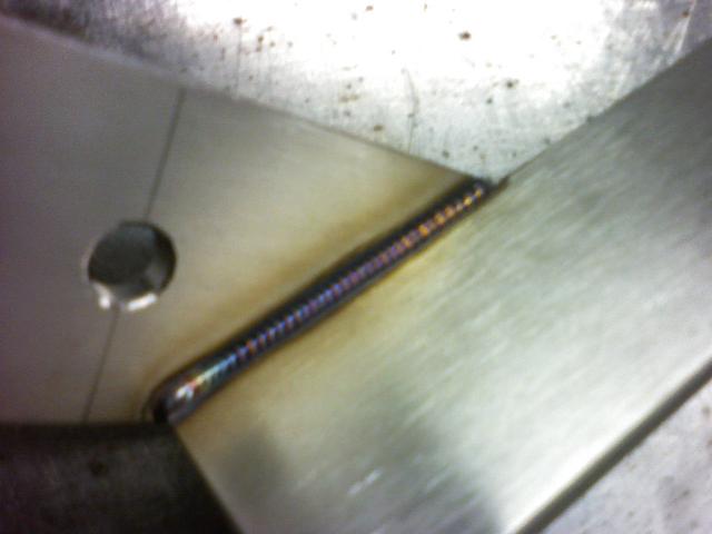

For something that small you are going to want TIG, You also want to use argon and sst welding wire. If you use standard mig wire it will be weak as all get out. Mig is fine for large materiat and structure, but for fine work it sucks. Stainless is very strong even getting a tack broken loose is a pain. Stainless will move on you as well. It warps easily if you are not used to working with it. If you need I could weld you up anything you need in sst. I do everything from 20 gauge sheet metal to 3/8" 100% through welds.

Yeah, I had read a fair amount about welding stanles a while back, and thought that tig was the way to go. Thanks for the info, and your weld is beautiful!!!
I may have to take you up on that offer. I have a lst based 6th scale buggy project in the "brainstorming" phase and I will need a front shaft made up out od a lst cvd. Can you weld stainless to steel, as I can imagine the lst shaft is chromed steel. I doubt it is stainless. I had to cut it with a fiber disk, the saw would not touch it so it must be hardened, or maybe stainless...
