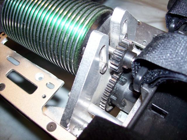

your a little off, heres what i got, i used the 5b tires since thats what hes got from the looks of it
Differential Ratio: 3.3076923076923075
Transmission Ratio: 1
Other Ratio: 1
Spur Tooth Count: 48
Pinion Tooth Count: 19
Total Voltage: 22.20
Motor KV: 1580
Tire Diameter (inches): 5.311
Tire Ballooning (inches): 0
Motor Current Draw: 0
Motor Coil Resistance: 0
Spur/Pinion Ratio: 2.53 : 1
Total Ratio: 8.35628 : 1
Tire Circumference (inches): 16.68 inches (423.8 mm)
Rollout: 2.00:1
Total Motor Speed: 35076 RPM
Vehicle Speed: 66.32 mph (106.54 km/h)
Effective KV Value: 1580
KT constant: 0.86 oz-in/A
Motor Torque: Amperage not specified...
Final Torque: Amperage not specified...
Final Power: Amperage not specified...
Yes - they are 5b tires - but they are larger than 5.3 inches (the tires you used in the calculator are Savage tires - not 5b). My 5b bowties are 6.8 inches. So I guessed a little less than that for his tires.

yes sir they are B5's 62 isn't but 10 mph's or so more than i wanted as a top speed. i really would like to keep the speed i have BUT ! i would like for this to be a middle of the road deal nothing on the edge so saying that if i get a CC XL and drop to a 18 cause i'd like just a little less topend would the controller survive ? i'd also like to try 8s with 14 pinion and see if the truck felt more driveable. im far from a newb but this 1717 is just a heli motor gone wild ! i wanted to go as far as Brian015 build but i didnt have the chops !

But you are closer to 80mph top speed if my 6.5" diameter is close. Can you measure your tires so the calculation is accurate?

WOW not reading my own tread ! i need to lower the pinion alot more

6.2 would be fair 160mm is what this digital dohicky saids !
