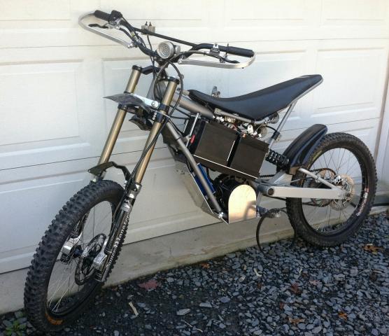

Got the modules installed last night and went for a night run! WOW what a difference the lipo conversion made. First ran at 66% current limit(200 amps) then in full power mode(300 amps at 74 volts in theory, though in unlimited mode it bursts higher amps). Full power mode is downright scary - I seriously am in need of a better throttle(only 90 degrees of twist makes for a twitchy ride) - I would like to get a 120 degree throttle to add some resolution for sure. The gearing tops it out at around 43mph and it gets there in a hurry! At 25, if you grab full throttle, it will throw you off the back unless you let up quickly - feels like a kx250 when it hits the powerband! I dialed in a progressive curve and went back to 80% current limit(240 amps) - theoretically limiting the power to around 20HP, which is plenty for a 150lb machine. I am totally psyched!
Oh...before i dialed back the power, i managed to rip the primary drive belt in two(hanging off the foot peg). I hope to get some body panels done this week to cover the batts/wiring a bit. Here is a picture:

pictures - 10.04.2011, 06:01 PM
the bike and the broken belt

Yeah, I clicked "post" a bit soon! That belt had a small blemsih on it when I got the bike, but it held up to the 200 pound machine on lead power without issue. It lasted about 10 minutes in its first daylight run today - thankfully I wasn't far away(had to push the bike home of course).
Hey mike, nice bike. What is the range on the stock bike? What is the expected range on your battery conversion? I love that you used basically off the shelf batteries, makes fixing and replacing components easier. If i ever lose enough weight, i'd like to get a E-bike for commuting to work. I would look into this setup, as i know the guy doing it is one of the best in the area of engineering and ergonomic and wouldn't sell anything that either doesn't work , or he wouldn't use or ride himself.
One thing please, If you do get into the E-bike area, please don't let it overtake the rc part. Would suck if RC-Monster didn't do RC parts anymore
Mike that looks AWSOME.
