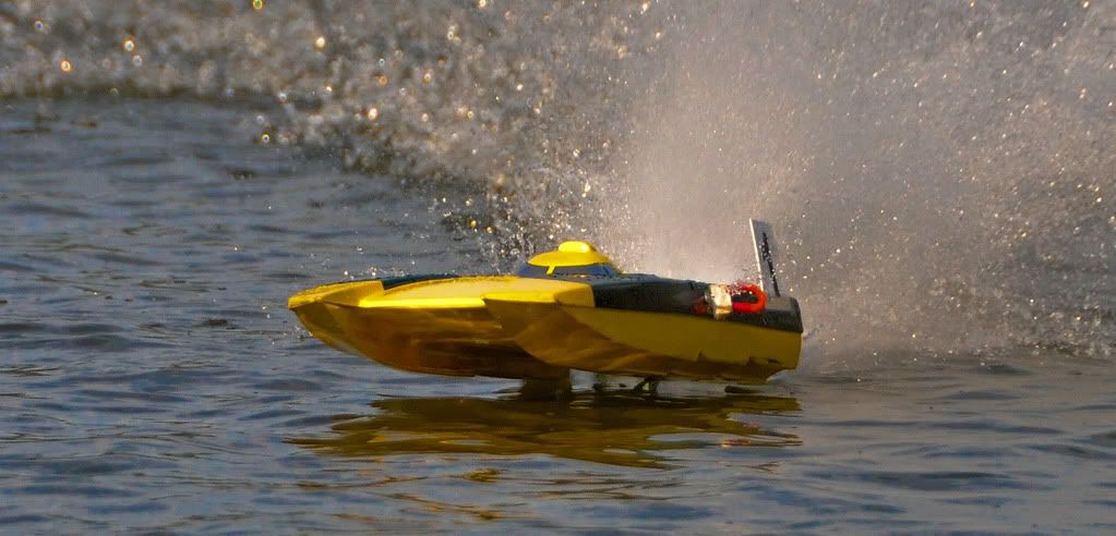

No that is the one that I called the Joysway offshore warrior, as Joysway is the manafacturer and that is the name they gave it, its a decent boat by any name though and I forgot that it is self righting too, it is a 17" mini size boat for 3s 2000mAh ish packs. The Tenshock Mono1 is a bigger boat at 23" for 2s5000/3s3500mAh ish packs.

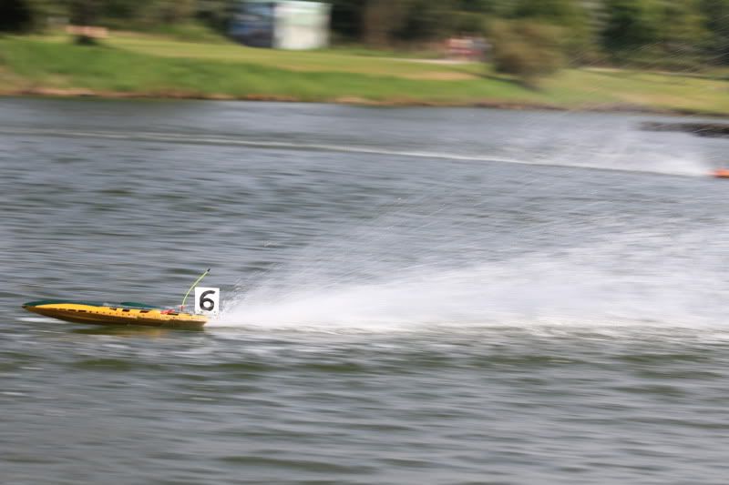

My Tenshock mono 1 , only thing Tenshock is the hull itself though as I got a good deal on it used and put my own bits in it.

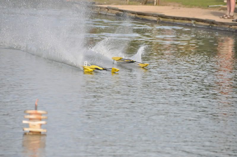

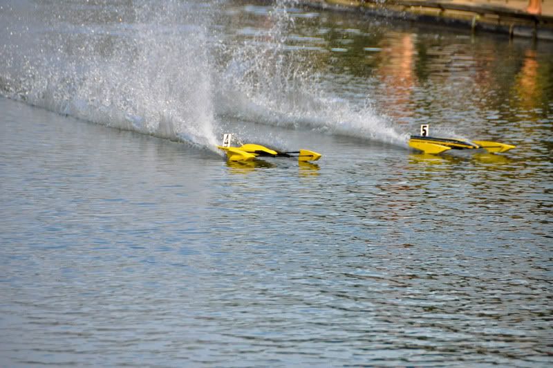

My JAE.21FE, there's nothing faster or more of an adrenalin rush than a rigger, they can get into (and out of) trouble so quickly they really do make your knees knock here I'm getting a little out of shape on the wake of another 4s Hydro that I am overtaking, and by the next frame 1/3 of a second later its settled back down to normal attitude as it was a second before.
My Aeromarine Mean Machine on 8s, coming out of the right turn onto the pit straight and flying nicely, if you like a bit of style with your adrenaline and enjoy living life on the edge, then cats are where its at.
