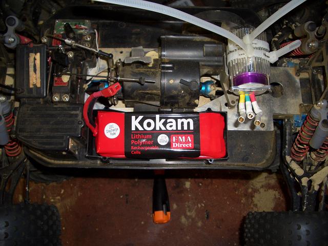

After removing the carry handle I can easily fit the Associated battery cups. Here's a quick view of how it may look.
I have to decide if I'm going to remove all the stuff from the front of the chassis (receiver pack box, receiver box, forward/reverse servo). The two boxes are molded together, from what I can tell. I may cut the receiver pack box out and slide the batteries forward.
With the tranny, motor, and steering servo set to one side, two 3s lipo packs may be just the right thing to offset that weight. Decisions, decisions....

1 3s pack will probably offset the weight.
I'll be running 2 in parallel, so I'm hoping that the 2 doesn't put too much weight on that side. I think my only other option in order to put a pack on the opposite side (with the stock tranny) is to try and re-locate the steering servo so I can move the pack forward. I'm pretty sure that's beyond my current skill and equipment, at least if it's to be done with any accuracy or reliability.
I've seen a couple ebay buy it nows (the folks that part out new vehicles) that have the stock chassis and rock guards for about $15, and I'm seriously considering getting one so I can hack up what I have and still have something to fall back on.
My buddy at the track/shop is really looking forward to seeing it in action this Saturday because he's been wanting an electric MT, but doesn't want to spend the money to make an E-Maxx brushless-worthy.
All things considered, if I can take a used MGT and have such a relatively drop-in brushless solution (and if the stock hardware holds up for a while) this could be a great brushless MT platform.
I've regularly wondered when Traxxas will come out with a brushless electric truck, but now that I see how relatively easy things fit on the MGT, why not Associated as the first ones on the brushless MT front?
