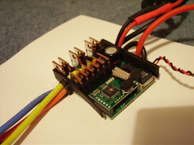

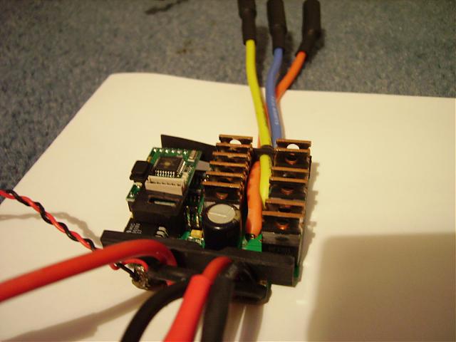

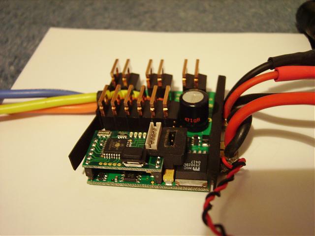

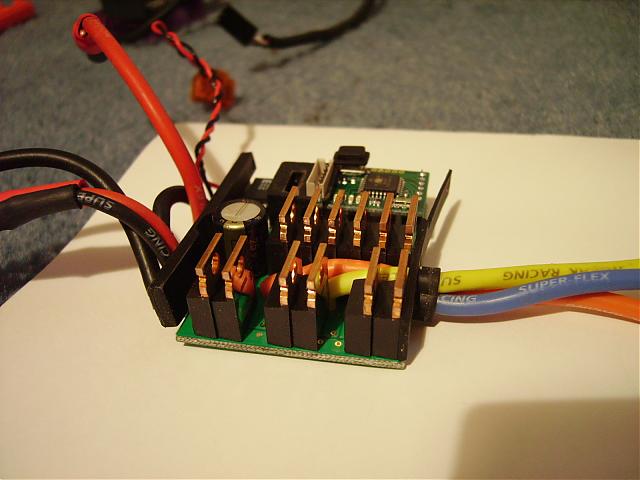

07.21.2008, 08:07 PM
So, I got round to fixing up the hvmaxx ready for re-sale. Whilst I had the esc case open (nice job on that case novak, it was a bastard to open), I took a few snaps, just incase anyone ever wondered what the inside of a hvmaxx looks like...
