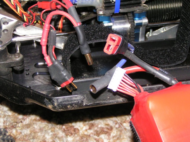

Plug in the deans (-neg and resistor) then the 5.5mm (+pos)
And I can still charge with the deans (no adapters) as all my chargers have deans.

bdebde, that looks nice and neat. Time to take out the soldering iron again once the controller comes back from MGM.
