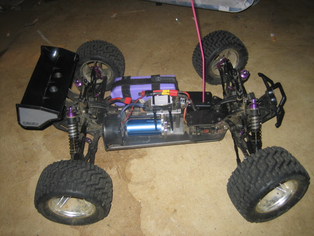

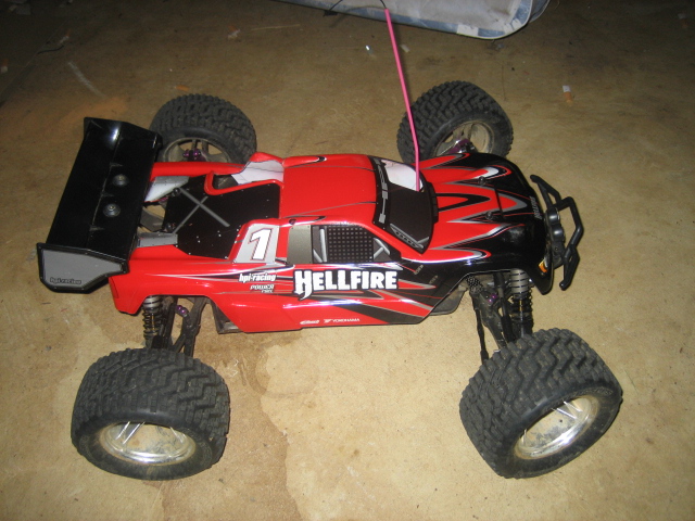

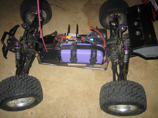

So, this truck just sat around in the basement until about a week ago. I got bored with busting up the tranny gears in my e-revo, and used the electronics from it to get the hellfire together. Here's what I came up with.
She's still a little rough around the edges, but running good. Although, I can only run it hard for about 15 minutes before I feel it's necessary to have a cool down period. I'm pretty well tired of feigao's. I need a better motor :). Right now I'm just biding time until the MMM starts shipping in a reliable form.
Any opinions, or general hellfire suggestions ?
J.

Well your work seems to have paid off. That looks like a nice setup, so how does it run? Have there been other Hellfire conversions? The Hellfire was one of the first R?C vehicles that I looked at buying, but I did not want to go in the nitro direction so I went with the Maxx line. I would imagine that with the rep of the Hellfire that it handles fairly well. Good luck with that, and go for a good motor like that Neu 15151Y.
83gt
06.29.2008, 12:23 PM
Handles great, although I need a stronger servo, or at the least a metal servo horn. The 9xl is pushing it around at good speeds. I need to get some proper wheels, as the ones I have I had been using on e-savage to widen the track. They are offset all the way out. It makes the hellfire look a bit goofy being so wide. I'm thinking on just getting the stock black dish rims and switching the tires over.
All in all, I really like it quite a lot. I have thought of a flat piece of aluminum cut on an angle to go from the rear shock tower to the chassis. Then I could use a delrin block bolted to the bottom and rear, using that to bolt to the chassis and shock tower. It's fairly firm as it is, but additional chassis bracing seems needed.
I'll definitely be looking into a MMM and Neu combo as soon as I can afford the shopping...
J.

Wow. I thought I'd perk up more interest with this one, being as there aren't many converted hellfires around here. Here's some more info....
The 9xl took a dump, so I ordered a 13t RCM pinion to run with my finned 8xl. I also switched out the BK 9920 for my quark 125b. Running with a 4s 8000mAh TrueRC. This should pack quite a punch, as long as the 8xl holds up. 13/52 @ 14.8v on the 8xl should give some nice speed.
If you noticed the wooden blocks under the revo battery tray I'm using.. that's temporary. I will replace the wood with some delrin or plastic blocks. The revo tray works pretty good for this application, so it will stay there I think.
I also want to replace the rims with the stock style black dishes. Although, the wide track is proving to be pretty fun. I can't make it traction roll for anything, even at 40mph +. It flies awesome. Very stable in the air, and easy to control. It's a lot more precise than driving the revo or savage, for sure.
I guess that's about it for now. I'm pretty much in love with it. :D.

Well, this is irritating. I switched out my bk 9920 for a quark 125 due to cogging from the bk. I also had to put my 8xl in since the 9xl took a dump. I'm currently geared 13/52 and I can run for about 5 minutes before the quark thermals. the motor is getting hot as well, but not much more than expected with a feigao. The ESC however, is roasting. I'm not sure the actual temp, but hot enough to shut it down.
I can't find anything binding in the drivetrain, and I can't really gear much lower than 13/52. I think moving to a smaller spur would be a bad idea.
I also have a problem with the spur skipping when I brake. It's fine in accelleration, but when braking, it will make a nice sound like the teeth on the spur are slipping against the pinion. I find the only plastic spur that works is kyosho ? I think there's nothing bigger than 46t in that, right ?
I really like the truck, but it seems I have a few bugs to work out.
