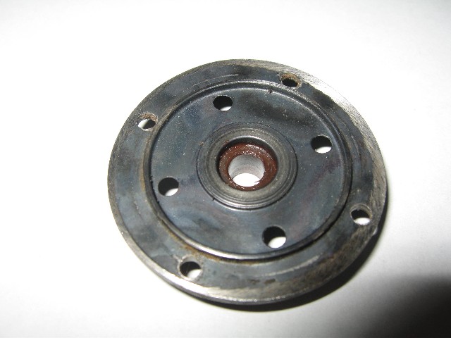

Here are some pix of one of the ones I made. It looks simple, but it requires some real effort to make it come out right.

04.22.2008, 01:46 AM
It certainly does require some effort...
