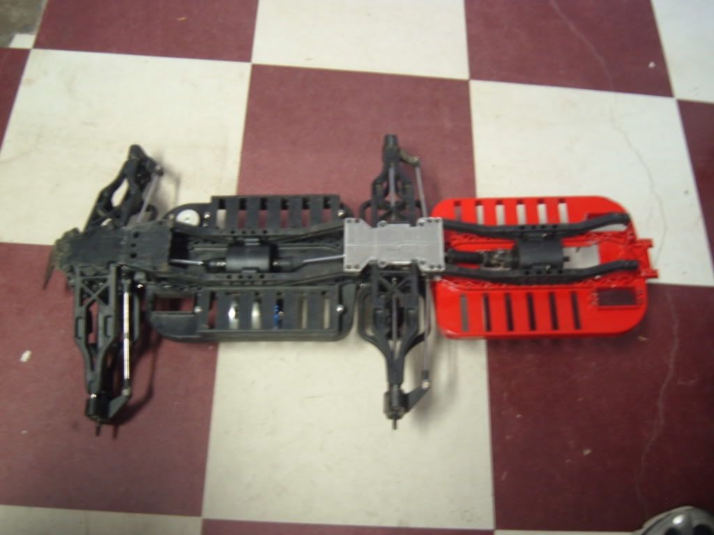

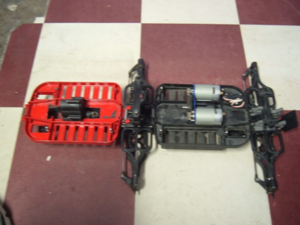

Update with pics! - 10.25.2008, 06:02 PM

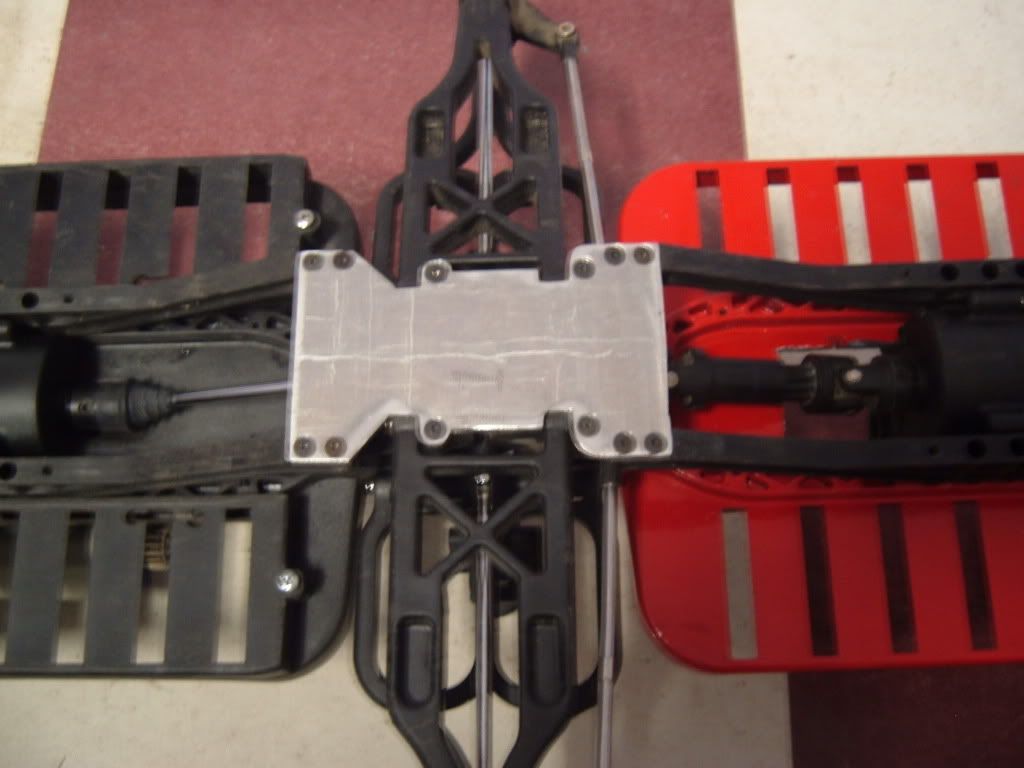

So I am getting there. Finished the center skid, greased the front and center diffs, and attached all of the suspension I currently have built. I need to scare up another 3.3 diff case for the rear. And one more steering bellcrank post that is hiding somewhere.

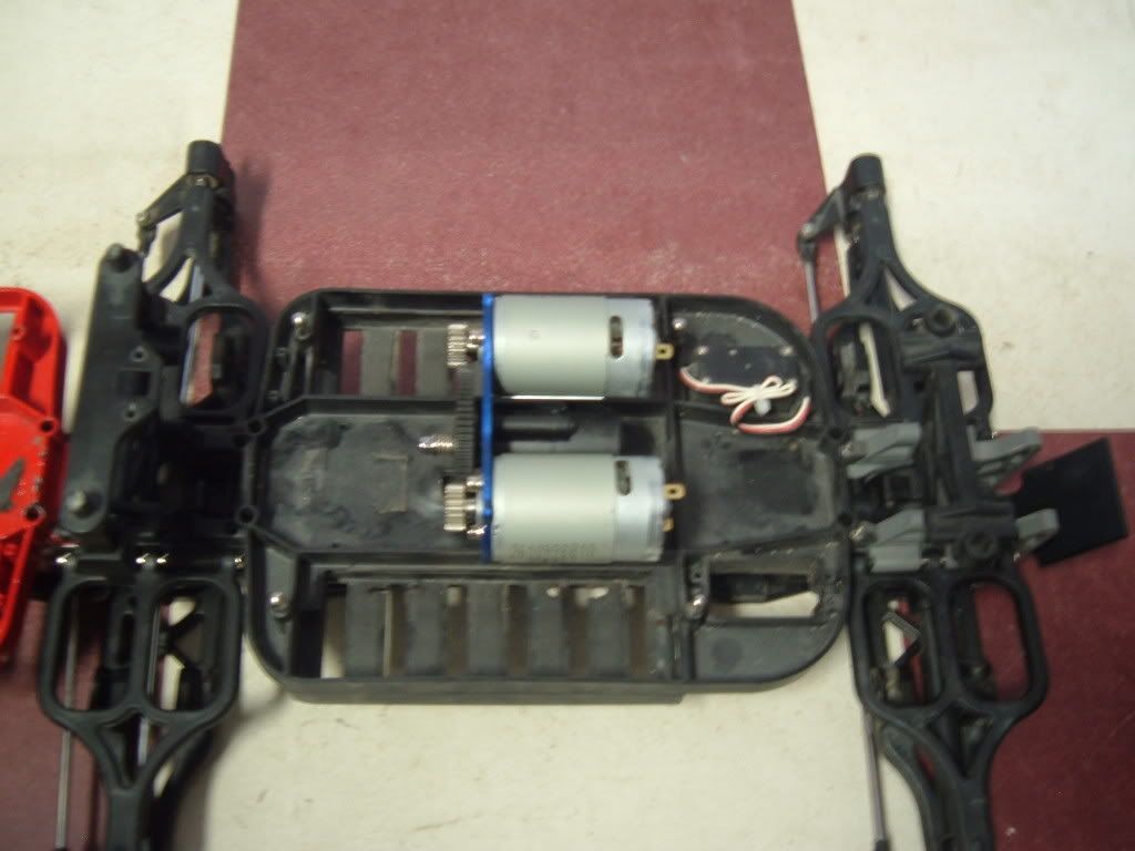

I also need to space the johnson motors back a bit, as the shafts are too short to fit the pinions backwards. I may end up using some titans, as they will fit without mods.
Yes, the rear chassis is red, I got it in trade with a bunck of parts, and it appears to be the only other emaxx tranny I have left... I guess I cut up all of the others to make battery trays... I will order another chassis when I make my next order, so for now it will have to do.

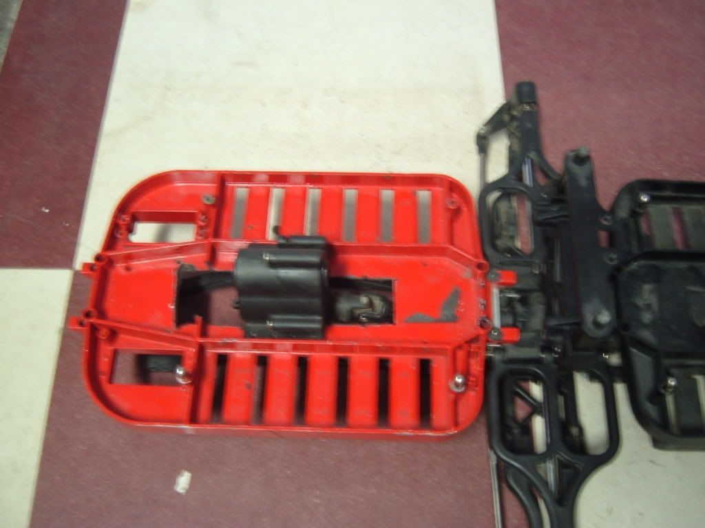

Are you using 4 motors? if not why not skip the rear transmission? use the rear chassis as a plat form for something, make it into a project x truck with rockets or something cool.
10.25.2008, 07:52 PM
Ah, yes, the rear tranny is only there so that I can use a pair of center driveshafts, and not have to make one really looooong driveshaft. It is empty save for the bearings and the lower shaft. I may put some sort of "project X" style stuff in it, but have a great idea that I will share as the build progresses.
