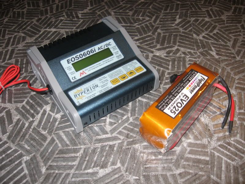

heres a short video. i cant believe how much power it has andd it wheelies even with the center diff in it. i got some q's about charging my battery. when i plugged the battery in i set the charger to 5s lipo and 4900mah is there anything else i need to set? and when i started charging it,on the bottom right hand side it said that the battery was at like 19 volts. so should i just not charge it since its only supposed to be at 18.5 volts? and how does the charger know when to stop charging?
04.07.2009, 10:48 AM
Sounds like you have it set correctly.
Are you using the built in balancer while charging? I just ask as you need the correct adapter board to charge a fp lipo as it has a thunderpower style balancing tap.
18.5v is the nominal voltage. 21v is the total voltage that it should charge up to on the charger.

yes i have a flight power balancer adapter thingy and i was using it and i will let it charge up to 21v. i love this charger by the way!!!!

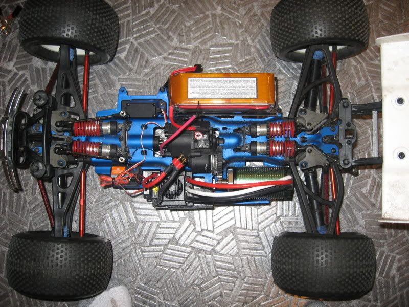

i just ran it outside and the front wheels baloon sooooooooooo much its almost undriveable. is there anyway to fix this? like putting heavier weight oil in the center diff or something? i am gona gear down a little and i stripped my spur gear again i think i might get a metal or aluminum spur. is that a good idea?

you want to gear up. Gearing down increases your torque....you already have too much..taping the inside of the tires will also help

ok then ill gear up. ill just get a smaller spur. what do you mean taping the inside of the tires? is there a thread on this? what kind of tape do i use? and what about oil in the center diff, do i want thinner or thicker oil?

Thicker oil in the CD will help the front tire ballooning. Not sure what weight to use though, I have never run a CD in a revo.

You'll probably need some 300k or so in the center diff. If thats not enough, about the only thing thicker is 500k and that might be to much. Also, to keep the front from unloading, you can go thicker in the front as well. That should help a little.

so are you saying to put thicker oil in the front diff? and will this setup eliminate crazy wheelies? im ok with a small wheelie as long as it does not hit the wing and the front goes down after you accelerate

you will need it in the CD, I tried 500k in a Traxxas CD in a converted Revo and it didnt do much...the TRX CD is crap IMO
