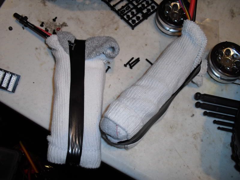

Since any thread is worthless without pics, I took a couple of the "snuggies" I made for my batteries. This is how we roll in the north haha.
