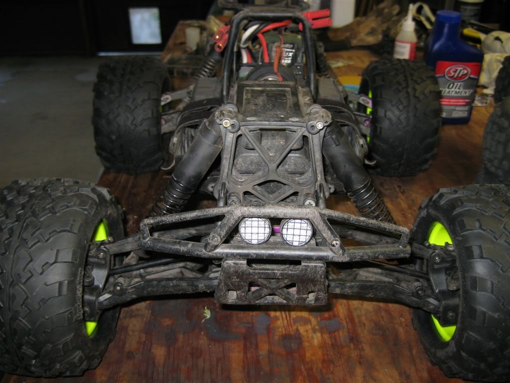

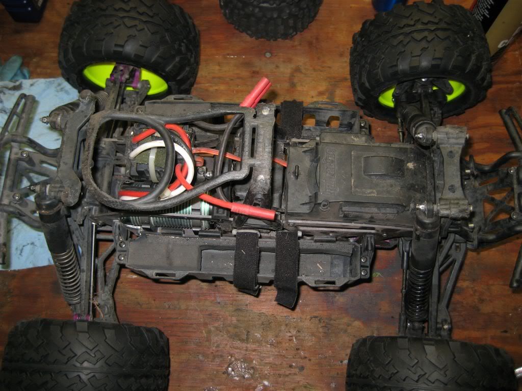

NIce post about the weakenesses of the Savage Flux. Just got a used one, and realy makes alot of noise, so good idea with the plastic spur, the transmission and diff options. It should make it less noisy and probably help on the weak diffs.
Here is a picture of the truck.
There are more pics in the second link in the signature.
