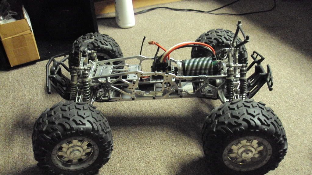

nice, do you have any info regarding gearing and runtime?
And do you find the deans sufficant to power it?
again great truck you have there, bet you have invested some time and money to put it together
10.22.2011, 12:32 AM

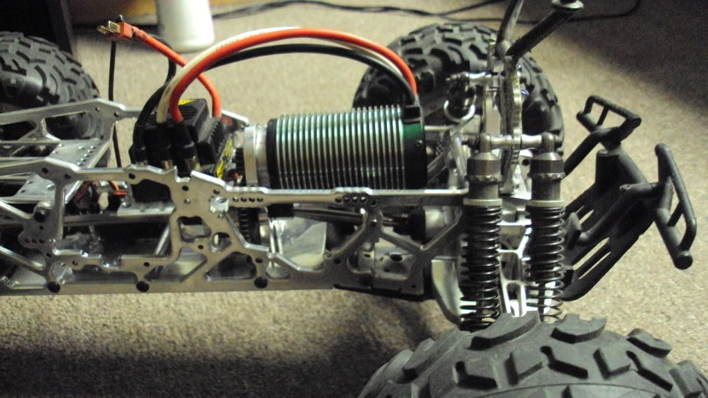

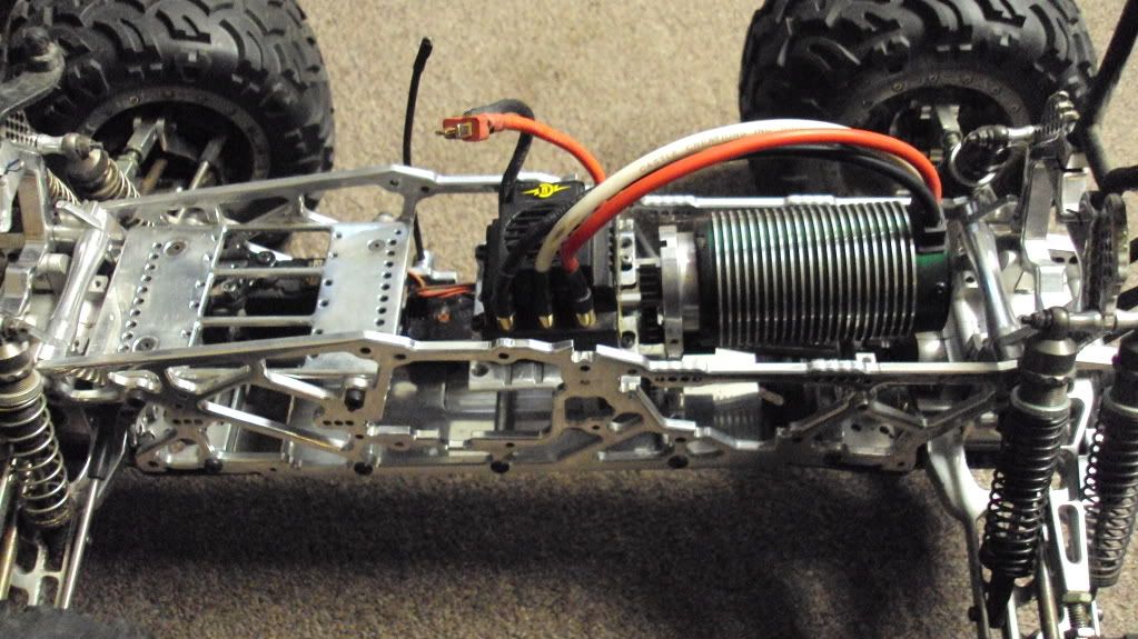

Gearing is 14/52, with the moabs it is geared for 50mph. I run a 5s 30c 8000mah zippy. Bashing hard it runs 40 minutes.
Deans soldered properly are the only connectors I use, I swear by them. I run them on my e5b.
The only problem I have, even with locker lube in the diff, is that the center diff gets too hot and the lube thins and runs out of the screw holes.

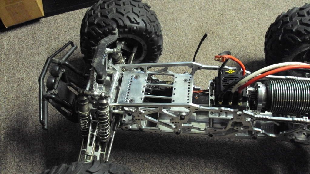

Hard to tell from the pics; but if you moved the speedo to the rear and ditched the servo plate (and mount the steering servo in the back) would that give you enough space to put the batteries in the front, for balance sake?
10.22.2011, 03:08 AM
It's been good to see you posting again serum!

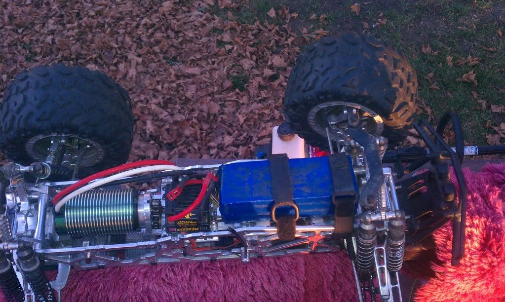

The batteries do mount in front, I strap them to the servo plate. They fit between the esc and bulkhead. It's very balanced.

a shot with a 5s 8000mah battery
