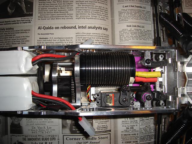

I'll post the pics in a few days when its fully completed and I get it back from Mike.

if you use a smaller diameter motor it would be even easier.

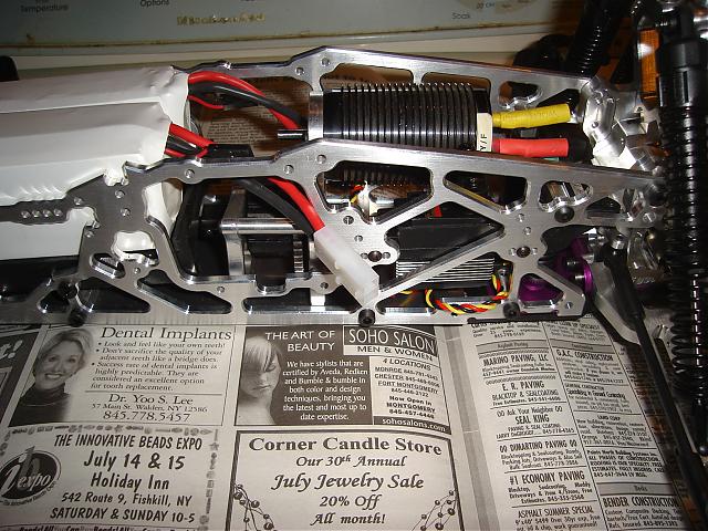

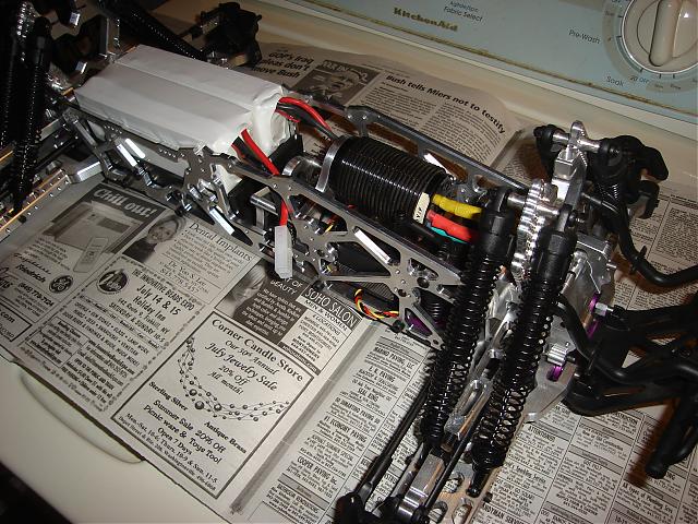

There's my baby :) I'm so proud her

....hmm..ok...interesting...Off to the side and to the front...I have just figured out how to get a hellfire center diff into my HPI E-Savage, as opposed to a converted GP, and it faces backwards and in the middle :D
...great eye-candy though...its all really helpful stuff...Just makes me wnat to get it done quicker...

really well done!!! This is the alternative solution!!
But all the weight is now pushed to the rear, it got not too heavy in the rear? How does it behave? (but ok, it's better to have some weight in the rear than in the front...)
In any case, the center diff will be helpful :-)
