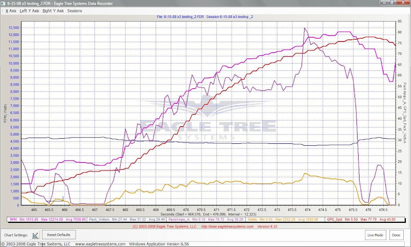

I would ditch the inline eagletree, it will be faster without. It adds resistance, guaranteed. i wouldn't use an inline measurement.
B4maz
05.19.2008, 05:02 PM
I just want to use it to see if my calculations for my amp draw were correct and I'm not pushing the motor/batteries/ESC too far. I don't plan on using it when I want to do a total "balls out" run.

With the eagle tree graph you can click the chart settings button then go to the export tab you can save the chart as a jpeg instead of having to do print screens.

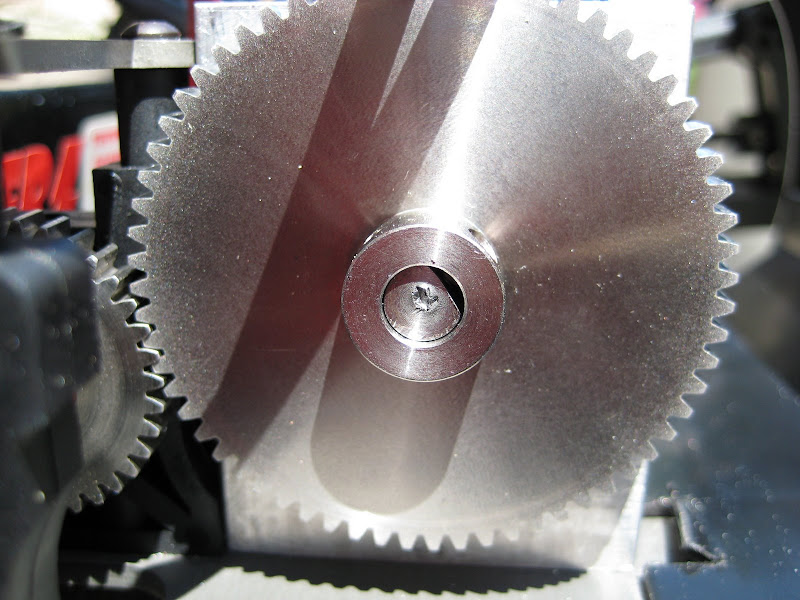

That is amazing how tall the gearing is on that and only 12000 rpm too. I'm also surprised you aren't using foams. Aren't the rubbers ballooning? Nice car though.

Ah, I was wondering how to get the graphs much clearer. Thanks for the tip. I hated when you would take a screen capture it would destroy the detail of the graph.

The pics that you mention of the foam tires exploding are from my previous car, the "X2". The car that I am running now is the "X3". The X2 was a front wheel drive all custom car. It had the same electronics as I am running now on the X3. The X3 is an off the shelf 1/8 scale 4wd OFNA Ultra GTP. All I did was convert it for brushless. The X2 had major problems with any type of foam tire I would use would explode. I tried just about everything to fix the problem, but no luck. I have not given up on the X2 I am putting it on the back burner for now while I do some more research and design on the tires. The X2 has a much much higher potential for speed than the X3. The X2 is half as wide, half as tall and half the weight of the X3. The X2 is direct drive as there are NO GEARS. The wheels are attached directly to the motor so there are no drive train losses except for the efficiency of the motor and motor bearings.
