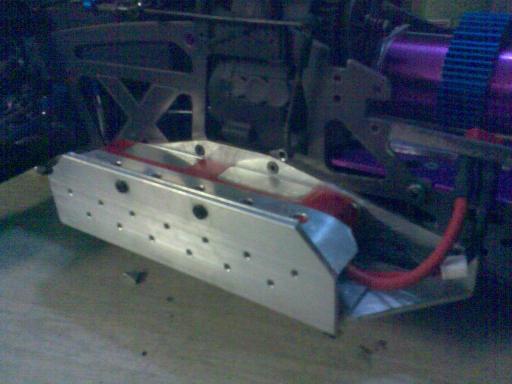

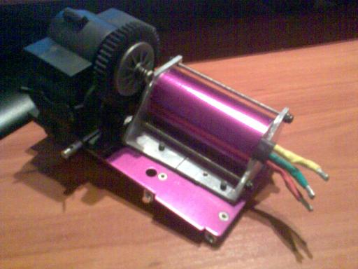

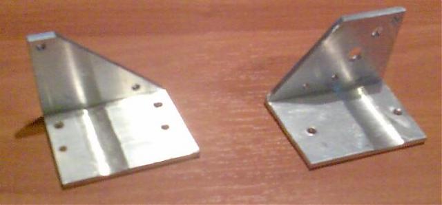

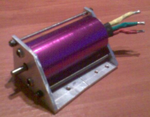

Haha looks familiar, heres my bro's solution for a savage conversion, including twin outrigger battery trays. Good having it clamped like that, though gearing is somewhat limited - no problem unless your aiming to break any world speed records.
