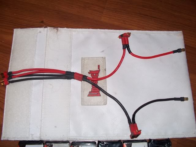

i went out and re-soldered the input leads so i will not have that problem again

I think you're wiring are too long. It will create resistance in the system and will cause your wires to run hot. Just my opinion.

`nah the voltage drop will be 0.5% of full voltage. they are 10g wire, in short thats not enough wire to create a problem with the voltage drop

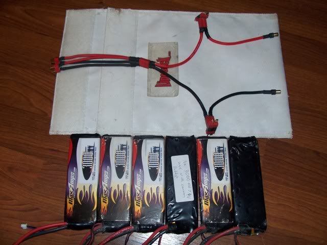

Way too much wire dude.
A much better solution would be to buy batteries that are actually suited for the application. Trying to keep all of those packs in balance will be no small task.

Sorry bud but you are dead wrong. Your calculation is based on everything being to perfection. You have way too many failure points in your setup. That much wiring and all of those connections will cause you problems period. That is one of the worst setups I have ever seen.

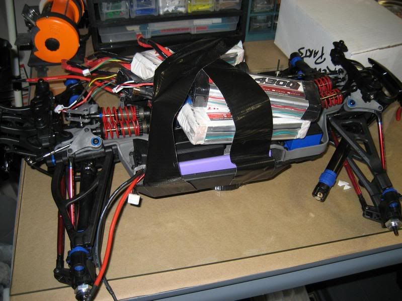

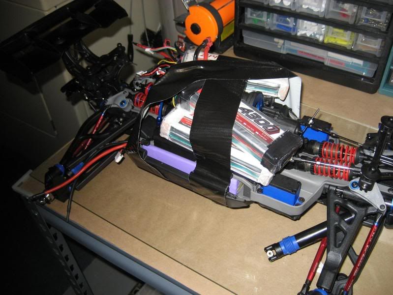

the whole idea of rewiring was to make it long enough so that they will reach. if i dont i will fry it again and again and again! i dont like making castle fix my mmm after i messed up in the first place!
next are you going to tell me my cc 5mm bullets are to small? or my 1515 is not suited for my aplication? i based that calculation on my electricions book, if you have one look under voltage drop.
