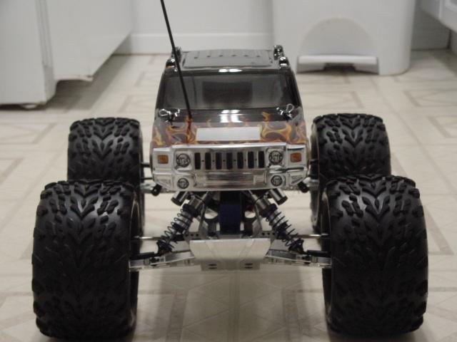

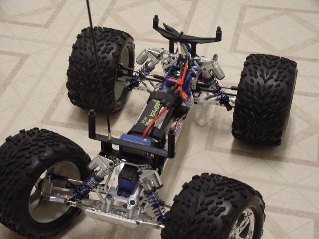

Ok every one, here is what is happening. The guys at aero model did some extensive testing on my setups that i sent them. They put them in the same vehicles with the same gearing. They have determined that the Quarks are not enough for these motors. Since i had purchased them from them, they were nice enough to instantly refund my money for the esc's. Those guys are no joke over there. Extreamly nice and helpful just like mike at rc-monster. top notch! So I have a mmpro 5700 purchased for my rusty. As for my pede, i ordered a mamba monster speed control along with the 18th chassis. i have the extended one now but i want it bigger! Gonna sell the extended one for now. Also putting my 5l motor in it. Ill hold on to my 6t for another project. Maybe put it in my 4-tec. Thankyou all for your help. Posting some pics for all you guys. Enjoy!
