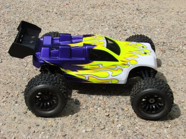

Made me wonder cause It looks Sooooo much better than mine that he painted.
Nah, I doubt I'll go that route ever again. Getting burned once is enough,rather not take a chance again at that. To many variables and a simple miscommunication could end badly. I've always painted my own but thought I'd take the chance just once.
09.18.2010, 12:25 PM
He did a much better job than Andrew did for sure. Don't blame you one bit either for painting your own...i just HATE painting bodies

09.18.2010, 12:50 PM
It is a pretty nice lookin body I have to agree. I can paint awsome with solid colours lol :)
