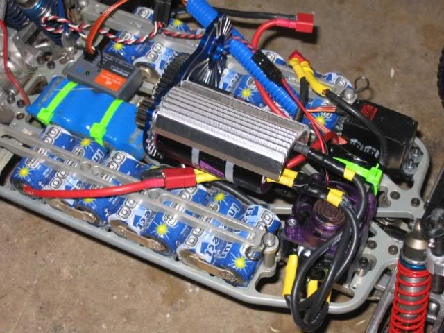

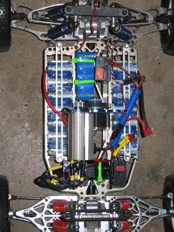

Here are some closer pics of the layout.
I'm really beginning to think its the controller to motor wiring. Spent a lot of time just tooling around in the drive way and the hesitation really only occurs when I ask for more than 1/8th or so of throttle. Consistently, and the hesitation is worse if I try to go full throttle. I find it hard to believe that its interference because it was so predictable. I did reprogram the controller and no change occurred; I also tried a different radio/receiver and no change.
Here's what the motor and controller wires originally looked like:
Do you think I should try and direct wire them or use some 4mm plugs instead of 3.5mm? Or do you think I'm just on the wrong path all together?

It could possible be a motor, esc, or even battery connection. Check em all and maybe consider 5.5mm plugs if you have problems soldering the wires into the small connectors. For temperary I would just direct solder.

I don't know what a 7 turn high-amp motor will pull for current, but maybe the 9920 just isn't up to the task? I know I've seen over 100A bursts from my BK Wanderer 8XL when I punch it from a standstill. Or if it's not that, maybe the ESC was overheated quite a bit burning out a few FETs and now is running on fewer FETs? I don't know of any type of current limiting capability in these ESC, but that's exactly what it sounds like.
One way to tell a bad connection would be heat. A bad connection creates a voltage drop, which in turn dissipates power as heat when high current flows. Wire and connectors should not be warm at all to the touch, or VERY little.
As far as direct soldering goes; it will be a better connection providing it is done correctly (no cold solder joints), but less convenient than connectors if you need to replace something. Just make sure the connectors are soldered well and they fit snugly together. The 5.5mm ones Mike has are quite beefy.

Brian - its been doing this from the start, and it does it irregardless of the battery pack I use.
I'm hoping for now that its not the battery wiring from the esc as I have little excess wire to mess with. I don't have a switch, so I have to unplug that batteries to shut the truck off and I have never noticed any warmth to the plugs/wires.
I am going to try the esc to motor connections next - probably over the next few days. I always felt a little uncomfortable with that connection because the 3.5mm plugs didn't fit all that well with those large wires (especially the copper windings coming from the motor). If the 4mm doesn't look like it will improve things, I will direct solder.

Brian - good point. I forgot to mention that I have tested the motor and controller where I have disengaged the pinion from the spur and the motor runs smoothly. I didn't give it full throttle for fear of exceeding the motor's rpms, but I did go over half and it turned without hesitation.
The truck will roll smoothly under 1/8th throttle on concrete and pavement, but any additional throttle and I get the hesitiation. Its less of an issue on pavement, but if I roll into grass its a mess. It also happens in reverse on almost any surface.
Definitely think its a connection issue the more I talk through it.
