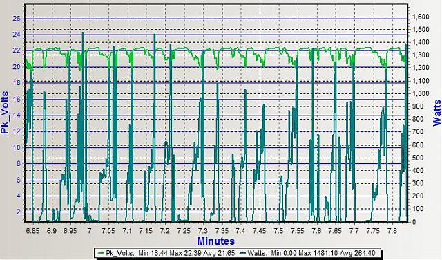

This run was done in thick grass, and it looks like this pack can deliver 1550 watts! It's not in the snapshot I am posting but later on in the data graph.
I will post this here, and on the other thread, kk?
I can sure feel the decrease in punch though, going from 2p to 1p pack, but it's still pretty good feel of power as I can wheelie at speeds up to roughly 32mph, of the ~<40mph top speed.

Also, I checked out the cumulative mah of the recorded run, it shows up as 2500mah! Every A123 pack I have had has always been quite a bit over th rated cap, which I'm not complaining about!
The max amps was 85 amps too, maybe I will post another one with amps instead of watts?
