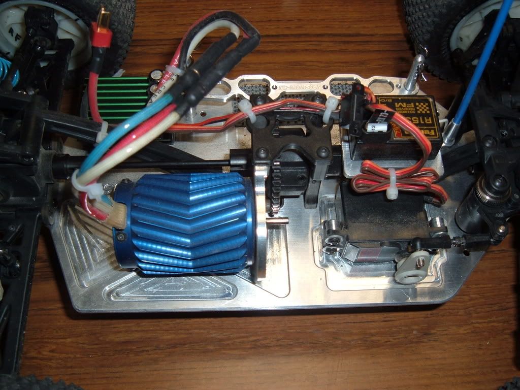

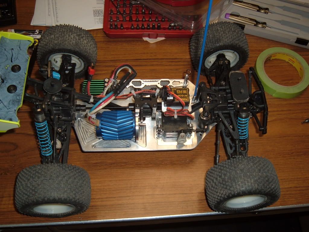

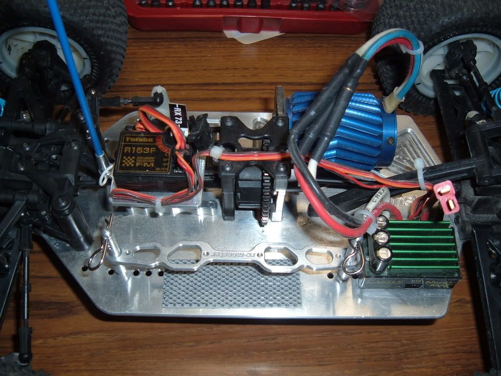

I am currently running a novak hv 6.5r in the crt.5 with the MM on a 5000 3s neuenergy lipo. Not really powerful enough for me, and it cogs badly at times from a standing start.
I have played with all of the settings and found that low timing, high start power, and the punch control disabled is the best. Still not very good startup. I will try direct soldering the motor to the esc, and then try another mm esc I have. Even with the punch control disabled, and the big battery, it still lacks the punch I would like. I may try thicker center diff oil, but it seems fine, not much ballooning.
