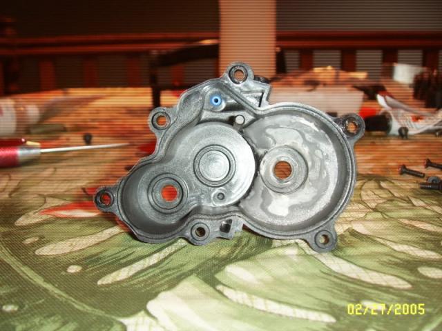

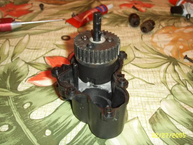

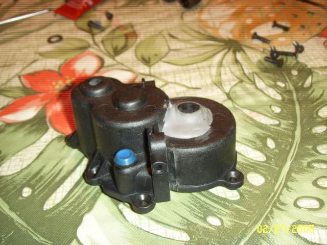

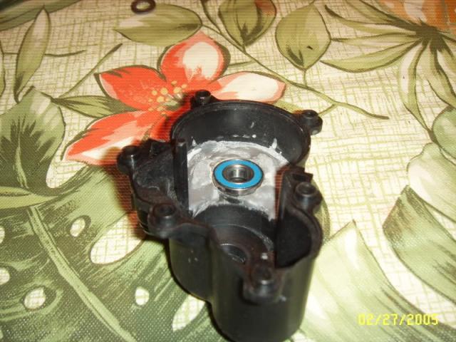

I used a lotta jb weld on mine. I had my friend mill out the weld for placement of an internal bearing inside the case. It is ultra sturdy and i've bashed the crap outta this thing and it's still hella strong never had to rebuild it at all except to put in 500k oil:

If I use an 8x12 bearing on the diff cup side and a 6x12 on the spur side it should fit in the stock trans case without any mods right? (except a little shimming)
Urgeoner did you use the JB Weld so you could have a larger bearing?
  (#70)
Urgeoner
Urgeoner's Avatar
Posts: 368
Location: The Town, CA
09.06.2009, 02:10 PM
I wanted to use the bearing that fits around the steel end of the diff case so yes. I shimmed a bit much initially and it wasnt that strong so I JB'd it up.
I also used a bit of the 3/4" black plastic spacer found on the regular fixed output shaft. You can see it in the first picture, it helps with the end play by further reinforcing the output shaft.
