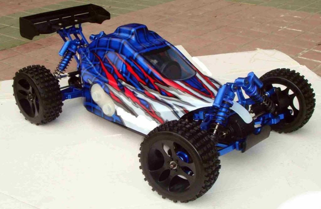

Here is a few pics of the buggy to help show what I want to do.
I have more pics that I have found online, but these show exactly what ya need to see. Its almost identical to the rampage in the center. See what I mean when I said youve been down this road before :)

is this buggy out yet? when do you get yours? where can they be purchased? i like that. i love how it looks just like a 1/8 buggy even more so than the rampage tt. it looks very agile. looks like a great conversion candidate.

They are still about 90 days out, unfortunately. Thats why its going to be a winter project for me. If the outrunner wont work with the direct to diff drive, I will just use a big inrunner using the direct drive with the pinion/spur, just like your conversion was.
They cant be purchased just yet, they are still working on the preproduction samples from HSP. I PMed Rob on RRF about possibly doing a conversion on one when they get released, and he said he would see if he could get them to build a brushless sample, after they finalize the gas version. Granted itd probably use the Hobbywing 150a ESC on 6s though, like most of the other chinese conversions. I cant imagine it being terribly fast on 6s, at least not much faster than a gas motor.

do you know if this new buggy is longer than the rampage and more like the length of a baja 5b? i know the new MCD v4's are longer than the predecessor to be similar in length to the baja 5b and more true to 1/5 scale instead of 1/6. i am wondering if redcat did the same thing to answer to MCDs new release.

Regardless of what powers it, that is a damn nice looking buggy! Being brushless will be the icing on the cake.

I have more pics since everyone seems to like it :)
Heres a few:
and the best for last :D
