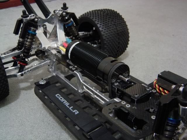

As you might be able to see, i have shaved the top and bottoms of the CD mounts down to lower the diff into the chassis a little more. I have also drilled a hole through one of the diff mounts which bolts to the motor mount too to help reduce flex. I am using two 3mm plates of carbon for the motor mount, again to reduce flex and hopefully prevent the stripping of spur gears.
Now that the motor mount is put together, the diff and top plate go on, nothing too complex here...

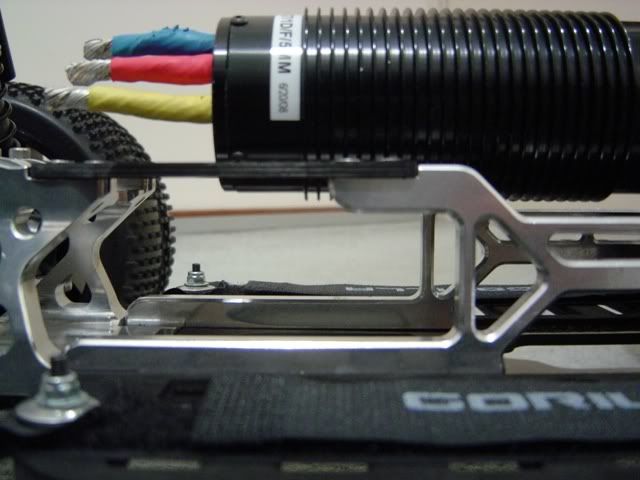

Now for the installation of the bottom plate, this is probably the most important part, because if the diff is not mounted in the exact right position the spur might hit the x-braces when on the chassis. Also important to countersink the screw holes so that the diff assembly can sit flush on the Gmaxx bottom plate:
With that done, you can install the diff assembly onto the chassis plate. As you can see i've had to drill 4 holes in the lower Gmaxx plate to mount the assembly:
I've had to cut out another rear upper plate so that the 1527 can fit with this setup. obviously with a 1515 sized motor i don't think this step will be necessary:

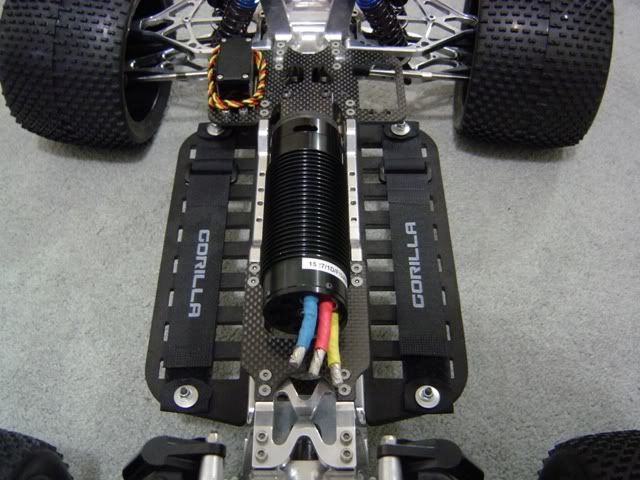

Nearly there.... Now with that done, the chassis plate with the diff assembly can be put back in. Again, it is pretty important that the holes in the lower plate for the diff and the chassis plate were measured properly so the diff sits central between the x-braces. With the 42t spur i have no problem with clearence between the braces!! No need for any dremeling there thank god :

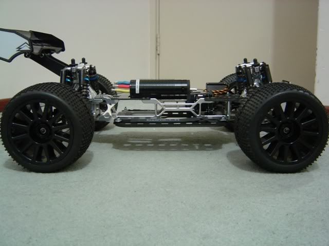

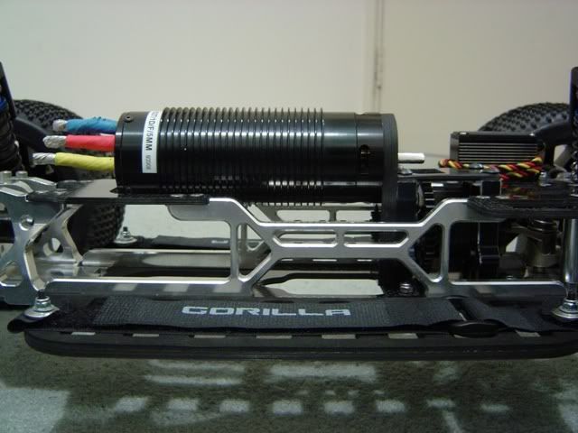

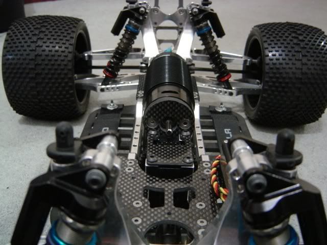

Now all thats left is to put in your motor!!!

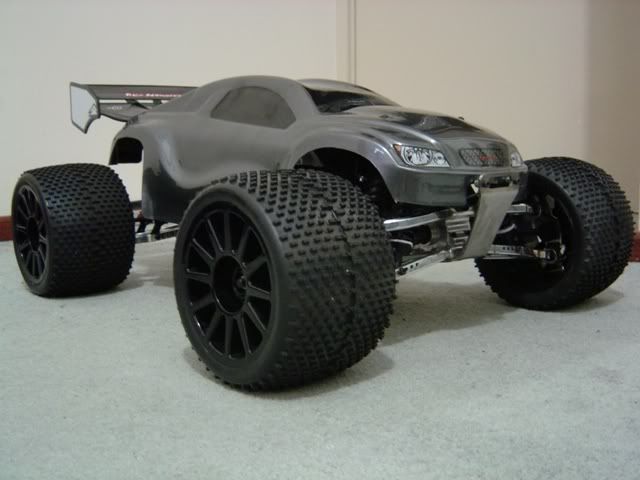

I also redid the front of the shell (again), now its got the CF grill and pink badge, very STI-ish i think:

very very nice indeed, its a clean and mean set up you've got there how was the torque of that super long neu? man that thing rips...post some vid too

Real nice conversion Jordan, that neu motor does must weight alot, doesn't this strain alot on the single carbon fiber mount?
Maybe making another sort of mount on the back of the can?

@supermaxx, thats a good point, i am going to make a brace under the back of the motor, but i need to get the driveshafts first to make sure i have enough clearence. It is surprisingly rigid though, with only one of the plates, it was flexing all over the place, but with two i can drop it from about 3 feet and there doesn't seem to be any flex in the motor mount.
