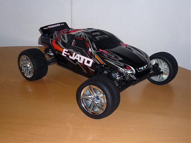

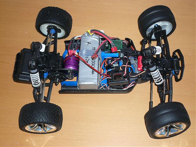

Just got mine ready, so here's some info;
Fresh out of the box Jato 3.3 stripped from all the smelly nitro stuff and turned into brushless beauty...
Bits and pieces:
Lehner Basic 5300 motor, Mamba Max ESC, 3S lipos, single speed conversion, 48p gears, RPM arms, CVD's & Futaba 2.4Ghz radios.
Testruns can be viewed at YouTube. Choose high quality video!
Pics attached. Insides are a bit messy because of the Eagle Tree stuff... :P

What motor mount are you using? It looks like an E-Maxx motor plate attached to the Jato transmission behind the slipper... Do you like the Jato more than your Rustler (the one in video on you tube) or do they drive completely different?

jnev: Thanks! Motor mount is selfmade from two pieces of 2mm thick aluminiun plate. Got the best fit when made it myself and being 4mm thick it doesn't flex.

Did you just have to dremel the shape you wanted and drill holes? What exactly was necessary to make the piece of aluminum fit?

I cut two pieces of (roughly) the same lenght from 50mm wide 2mm thick aluminium, put them together and drilled one 3mm hole for the motor mount. Bolted them together from that hole and drilled the remaining holes with drill press. Exact hole positions are vital, so atleast caliper must be used. The mesh adjustment hole was made from series of 3mm holes which were opened with dremel and the hole for the motor axle was made from two 10mm holes. The hole from where the transmission case comes through is quite snug fit, so it doesn't allow any slack or twisting which might strip the screws from transmission case.
The final rounded shape was made with belt grinder, with pieces still bolted together.
First I thought that I'd polish the final piece, but I ended up spraying it with black paint (I'm lazy...).
All the tools needed are available at the place I work, so you could say I'm fortunate. Ofcourse, no workingtime was spend while making this...
