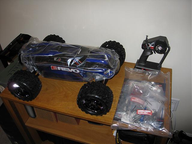

I went by the LHS today and picked up the e-Revo. They had what seems to be a pretty good price @ $439.
Some pics to follow, but here are my first thoughts out of the box:

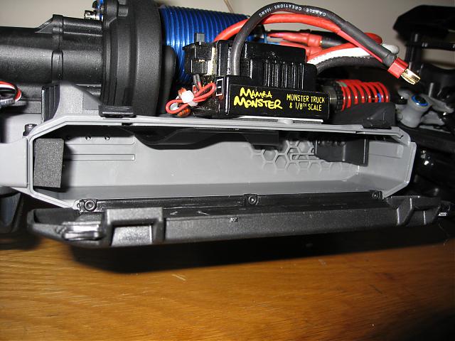

2 - Battery Trays - I don't think people are going to want to run pack that are 30mm high - they will just fit and with no air circulating they will be really high. I put a Neu 3900 3S pack in one side and it fit very nicely. I think the limits for a battery pack are going to be:
48-50mm wide - there is a little extra space in the battery door when it closes
25mm high - This is the highest I would want to go for the pack to be snug but still allow airflow.
160mm long - if you stick with the 25mm height there should be no problem fitting a pack this long.
I think and 3S 5000mAh Neu or TP pack will fit very nicely on each side. I am going to be getting the TP eXtreme V2 3S 5000 mAh packs that measure 25x48x160 and run one on each side for 6S total.

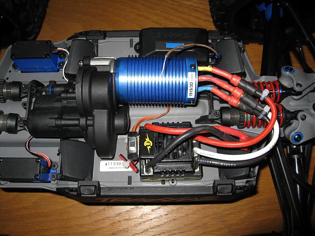

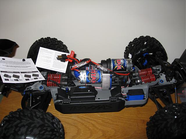

3 - Motors/ESC/Radio/Receiver - Haven't even run them (and never will) - pulled straight out within the first hour out of the box.
-Motors are brushed motors and seem beefy, but I just have no interest.
-ESC - seems solid, but once again no interest.

5 - BL motor mount - the only pinion I have is a 24T 32P pinion and I had to dremel out the lock nut area to allow the motor to move far enough away to lock it in place. Once I can figure out all of the gearing I will pick up a few more pinions of more appropriate sizes. I'll be keeping an eye out for when the single BL motor mount option part is available.

First pics.

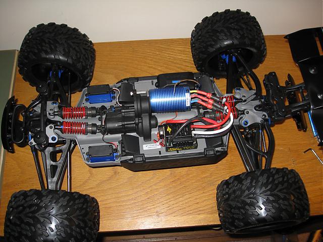

More pics.

just a quick question but how do they wires for the batterys come out of the casing??
Take a look at the middle pic above your post. There is a notch in the upper right corner of the battery tray where the door closes. Looks like it will fit 13GA wire pretty easy, but I did a test fit on a Neu pack with 10GA wire and it was snug - I would be concerned with rubbing and would dremel out a bit.

drkros3
06.15.2008, 01:20 AM
i see it now. thanks!
