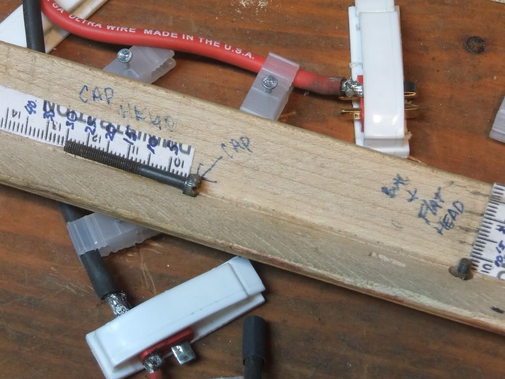

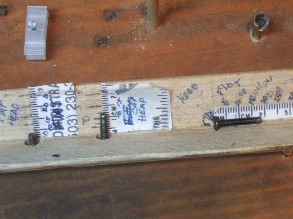

Next time you tell her it's 12mm. Tell her with some confidence. Measure it first by creating this handy little jig. Just drop the bad boy in the right spot and now you know for sure.
Just take a ruler make a photo copy or two to cut out. A short piece of corner molding. I put an indent in it where you put the head to measure it from. I had some extra time LOL so I also drilled a couple holes and put a screw in the size I was sure or then added the photocopy of the ruler to it. All the measurements start the bottom of the head. She will feel so much better knowing that when she asks for a 12mm cap head. That is exactly what you are going to be giving her.

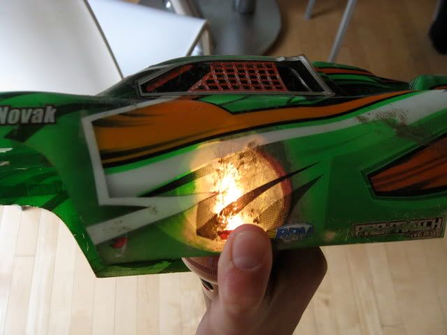

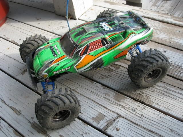

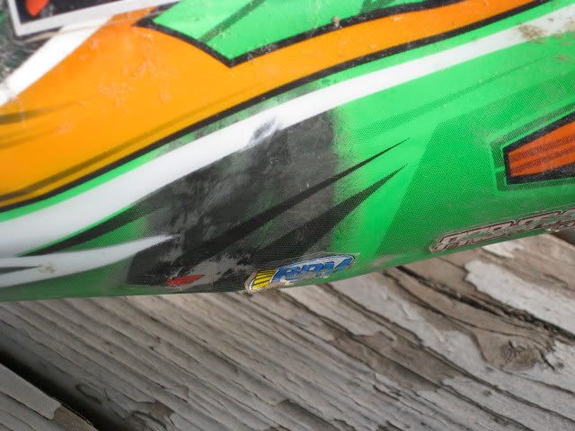

When using a LVC or a similar device, they have lights on them to tell you if the battery is low, but with a body on, it is hard to see. Take some acetone (Nail polish) and put it on a cotton pad, then rub off the paint on the body on the section next to the light. So when you are in a run, you can still see the light.
I couldn't ask for it to work any better.

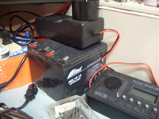

2. Gell cell or lead acid batteries are great for charging batteries away from power. Your charger can probably hook up to them with alligator clips. I have two from an old electric scooter. These batteries have tons of uses.

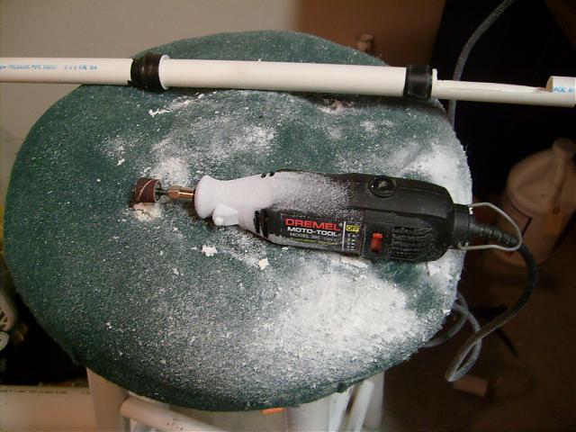

3. chairs or stools are good for sitting on, but also make a good PVC dremeling location.
