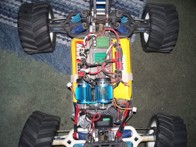

Here ya go man! Always nice to help a fellow RCer.
Remove the Black tie downs from both ends of battery tray (I think it was screwed in from the bottom. )
and use a dremel tool to remove the grey "wall" in the back to make the tray longer.
cut a small slit in the chassis the allow velcro to slide through.
also a small cutout in the front for the wire to pass through.
PS Never had a problem after dremeling that part away, didnt seem to weaken it at all. because I snapped 2 chassis' after doing this and never was broken near that spot.
Now I have to take an updated shot of her because it looks nothing like that anymore. LOL

I guess this sums it up. Here is a tray from a 3905 I used as a battery tray for my FLM chassis. Perfect fit.
And no I dont run them on the bottom, I am in the process of making a lower AL plate.
There shots from this year...
