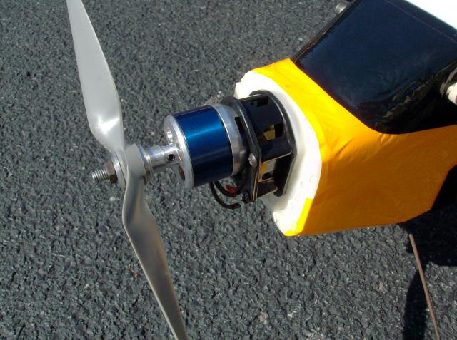

Now let's talk POWER :) I'm using a Waypoint 3014-16 1300kv- http://www.allerc.com/product_info.p...oducts_id=3860 on 3S with a 17,000 RPM theoretical max. Eliminating the gearbox makes for a much smoother sound and feel. But you'll want to maintain your downward and right offset to the motor as it counteracts torque roll. This is done by cutting the nose off the gearbox molding, and retaining the rear half. I am using a Castle Thunderbird 54 ESC, just for lots of headroom to prevent thermaling under prolonged full throttle. The max draw with this motor is around 35 amps with an APC composite 10x7 prop.

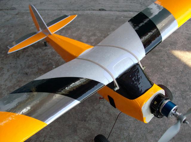

Motor and mount mods...

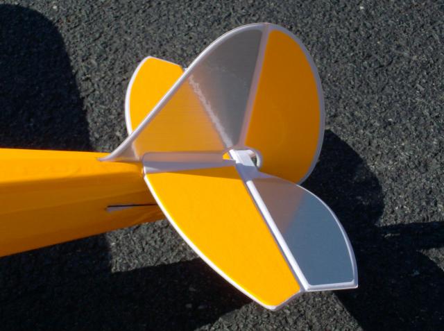

It wasn't intentional but I love the transparent effect on my tail scheme :)

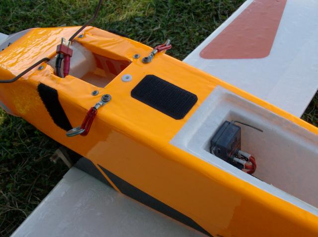

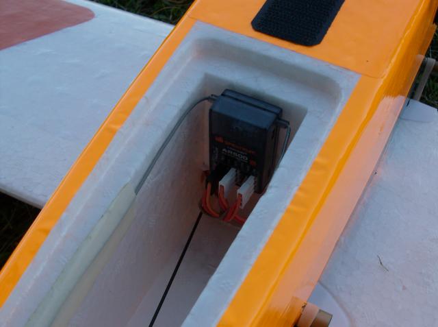

Battery compartment was hollowed out so that a 3S 2200 fits in flat with the rear portion under the servos, and the RX moved into the tail.

I got the Waypoint motor because for a relatively small motor, it has a 5mm shaft. And because the prop hub butts right up against the rotor nose, there is almost no way for the shaft to get bent under a hard nose over or nose in. You can do it a lot cheaper, and I would go with this motor- http://www.hobbycity.com/hobbycity/s...6_910Kv_/_310w
Not quite as hot as the one I have, but still tons more punch than stock. I really don't use much over half throttle 90% of the time- it's stupid overkill!
