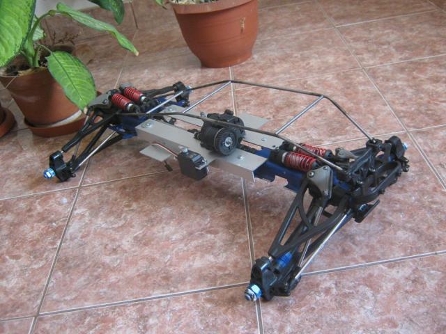

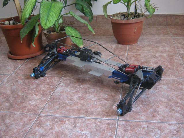

OK i changed my mind... I will make it a baja tipe car...maybe a sandraill tipe car.
So i started on the roll cage.I will be more complex but I need to figure out how I want it to look at the end.I like the black sandraill in the picture I posted.

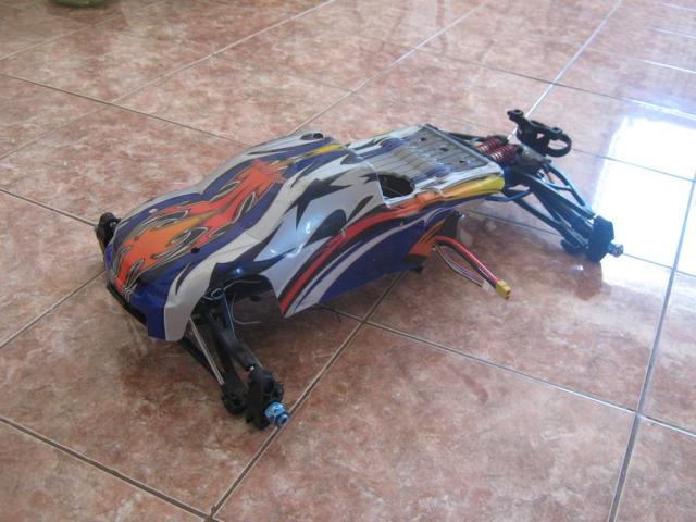

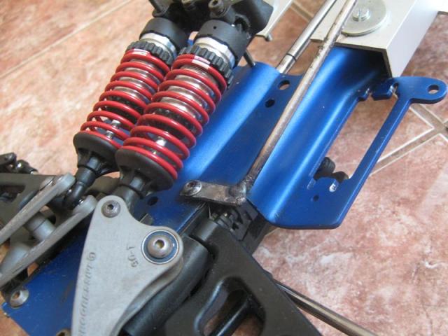

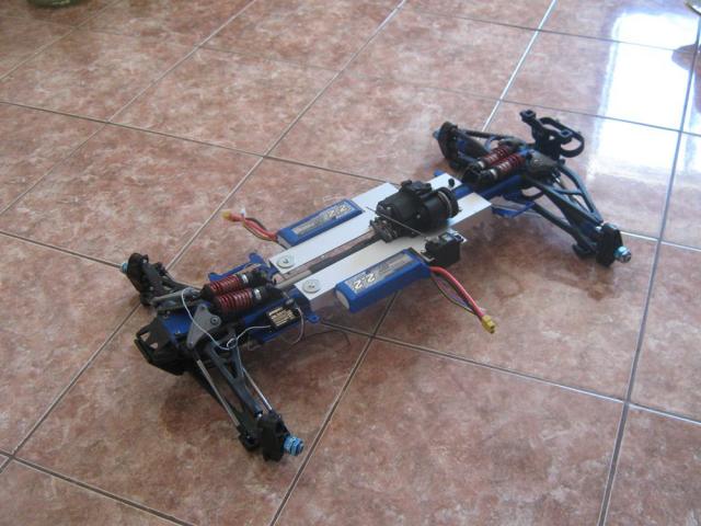

09.05.2010, 11:57 AM
New pic!

09.05.2010, 12:28 PM
Thats looking pretty cool so far.
