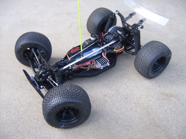

The only one I have experience with is the Losi XXX-4 G+. Great buggy, but you're limited on the front tires. The front have hexes and the rear are pins. The best tires I had on mine were the Pro Line Dirt Hawgs. That made the front tires pretty big actually.
With my Neu 1105 motor in it, that thing flew! Check the pics. It was a little dirty, but you can see what the tires are like.
i could be wrong but is that a quark 33a it bearly looks like it (if it is how does that handle that big of a motor) otherwise i was looking at buying one of those i always loved they way they looked. How does it perform. handle bads and goods you know me before i buy i want to know all types of info. Aslo got a vid. (-its one of those in the back of my head kind of projects it might happen but later on if even)

Yeah, that's a Quark 33. It works fine with the motor really. I don't have it anymore, but I owned that thing for a while. Just found out I bought that XXX4 from jhautz! Funny, eh? Then I put that power system in it.
The good side of doing that system was that it was silly fast. Fastest thing I've ever driven. You know, one of those that makes you think it's too much power? Very rare. Anyway, the bad side was that it was almost too light. I used a 2100 mah 3 cell lipo, that smaller motor, and the Quark 33. The thing was about a pound lighter than the typical setup. That meant it would get thrown around on a bumpy track a bit. Otherwise it was awesome.
My brother in law runs his with a Mamba 25 actually. He took the shrink wrap off and has a fan on it in a certain way that it keeps totally cool. Actually cooler than my Quark was.
I would say that setup could easily do 60mph. I'm serious, it was silly. Totally laughable when you drive it, you know? Anyway, hope that helps. Sorry, no vids. I spend too much money on RC to buy a camera. :027:

how does the quark 33a handle that its made for 1/18 scale cars. Also what motor is that.
Sower
Sower's Avatar
Posts: 957
12.22.2006, 04:27 PM
Basically it means that the motor doesn't even get warm. It's a Neu 1105 1.5y (6800kv) and it could take more power than this system could dish out.
You're right that the Quark 33 is for 1/18th scale, but it all comes down to the battery. If the battery is only going to push out 30 amps, then you're cool. Here's a chart with the specs on the motor:
