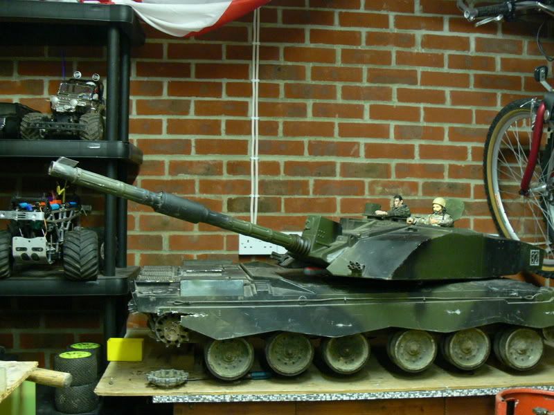

05.09.2007, 01:13 AM
Got a picture of this beast? Sounds really cool!
to make it...
or break it...
Silent...But Deadly
cabking
05.09.2007, 07:24 PM
just one :028:
I'm looking forward to crushing a few Touring Cars with it.:027:
