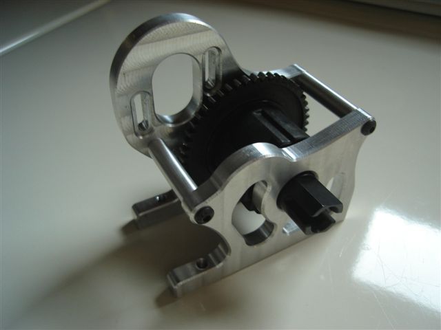

An interesting thing I saw was a set of flm tvps which use nitro savage ends with a e-savage tranny in the middle. Some one has probably mentioned this before on here but I though I'd mention it again. The thing I don't like about that setup is that the batteries are still on the out side of the truck.

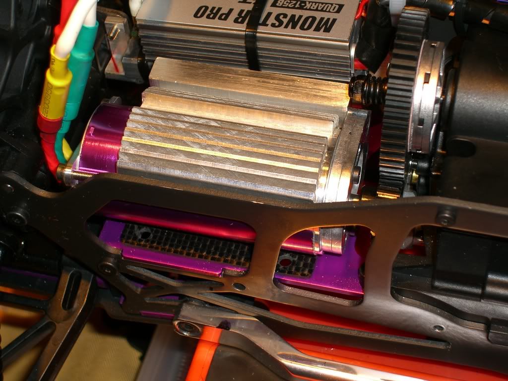

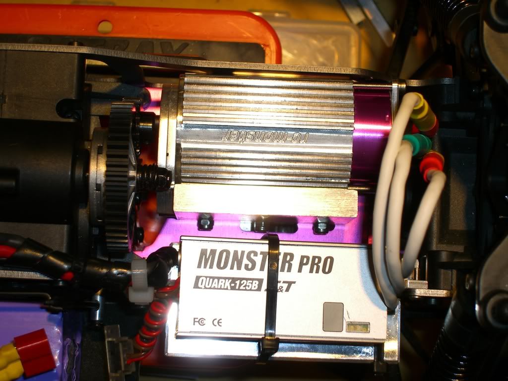

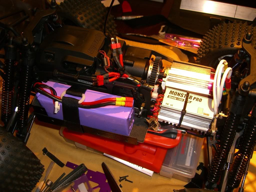

Originally Posted by rjmacmillan View Post
has anyone put a emaxx single speed or a center diff successfully in their savage?
Here. Center diff, over one year ago. WIth 5S 8000mAh batts inside the TVPs. And now Mike has a nice mount for a direct drive center diff in a savage, should hit the store soon!

That's the best thing I have heard all day Daf. Mike sent me an e-mail about this with pics and I replied but got no response. This is exactly what I wanted to hear. Imagine if mike released this and the Castle release the MMM. I think I would pass out with excitement.

It uses FLM ext. tvp's.

Is that a more finished version of the truck i saw earlier serum? It looks like it. I love it and I can't wait. Any pics of the battery tray? I assume we are going to have to make that our selves?

It will come with a battery tray. Maybe Mike will even provide different sizes, but this 5S (Either 7400 Apogee or 8000 Maxamps) is a rather obvious choice, since they fit so nice in between the TVPs.
Daf
MTBikerTim
Yip Yip Yip...
MTBikerTim's Avatar
Posts: 1,489
10.19.2007, 02:37 AM
That's awesome news. I am slowly building up my collection of tools but I'm still not there. It sounds like it's almost going to be a complete kit. So will dog bones be included or are they a mix of standard length ones?
