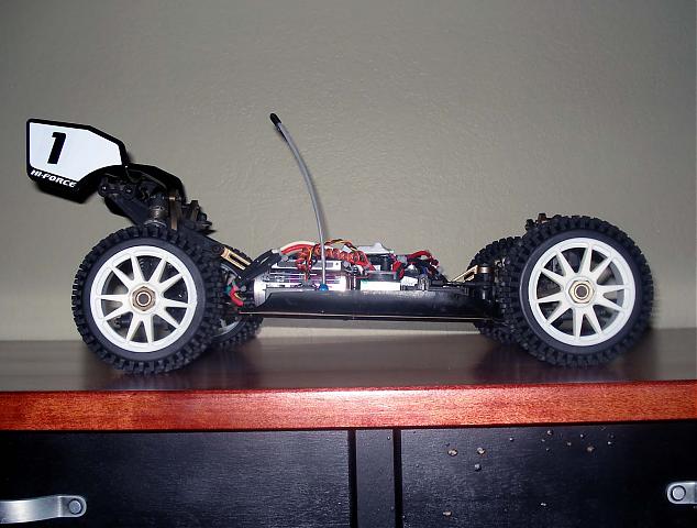

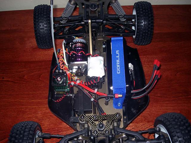

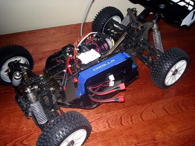

Been working on this on and off for the last few months. I did i crt.5 project in between, so this project has been on the backburner for a while. Now its nearly done!
Its your basic Jammin X-1 CR conversion...
- MM / 8XL with 18/48 gearing
- 4s 6000mah lipo (two 2s packs in series).
- RC-Monster mount and ubec
- Jimmy rigged battery holders using some spare C.F. and some random car parts. Its surprisingly strong.
- custom body in the works by Dafni.
I've just been putting the finishing touches on this over the last week.... added a fan, cleaned up the wiring, changed the wing, etc... Its all set to test, but its raining cats and dogs in Nor Cal right now. I hope to be able to get some good park testing in this weekend. Or maybe go to Sacremento for some track runs if time allows...
Anyways, thought I'd share pics of my progress so far. Sorry I don't have any build pics. I always forget to take pics during the build...

Looks good! I'll tell you from my E x1, put the cf servo strap back on, it will prevent a lot of the flex in the steering mount. Or, you could get an aluminum mount.

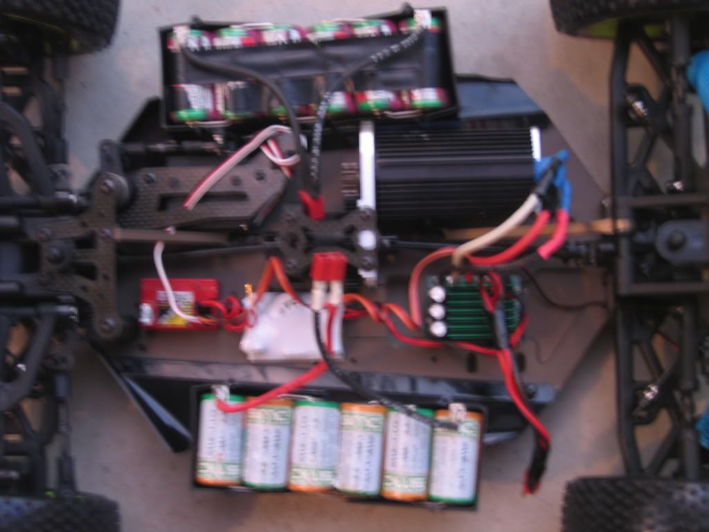

Some old pics. Waiting to get the money to go lipo like yours.

I made my own w/ some c.f. and spare parts.
Looks like Supra is using a modded traxxas batt holder for his. Or something similar.
I got some modded traxxas battery holders from Kershaw designs for another project. check them out if you need a ready made battery tray.

I just used some ae batt cups off of tower, but rschoi has the better idea.
