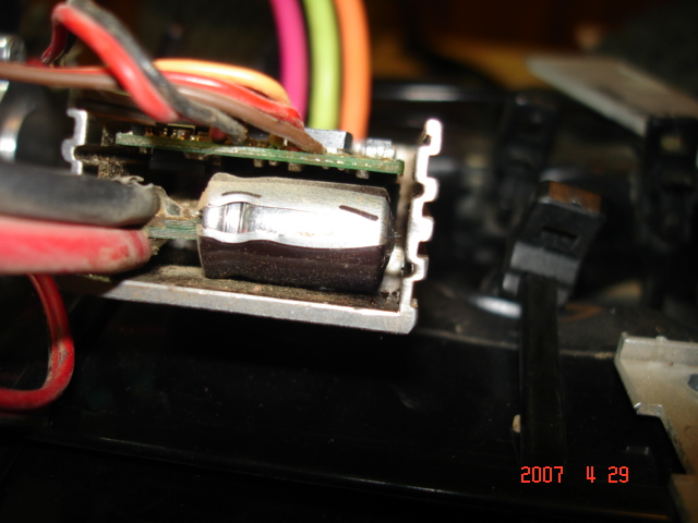

Hey guys, I hate to be the crying baby of the bunch, but...I ran the truck this morning. It's getting HOT down here now. I ran for about four minutes and it thermalled.
I had had enough so I pulled the Quark apart and guess what I found. The pcb was moving around in the case pretty easily, so I started to peel the heat spreader from the case and get this, the adhesive on the FET side of the spreader just let go. It came off completely in tact. Check out the pic...
Do you see the indentions in the thermal pad from the FETs? You don't because they're hardly there. It looks like fewer than a third of the FETs were actually stuck to the pad.
Apparently, whatever lubricant it is that is used in the manufacturing process for the chips wasn't cleaned off.
What is up with S&T?

I got these, 3 of them actually...

cemetary gates: They should work alright, if they are Low-esr, but I don't know of any, if any low-esr caps that have a running temp of only 85c. The more caps you add, the lower the operating temp they will have, as long as they are low-esr type.
BliPoRaceR: That is the ideal way to mount caps yes, but like AAngel said, it's too exposed for my tastes. The way AAngel mounted his caps on his MM, and Quark is more what I like, and the resistance from adding that little bit of wire is minimal. But you sure would want to keep the caps on the pcb (stock).

Oh, yeah, I don't think those are low-esr caps. If I were you, I would not install them, they will most likely blow out and spill electrolyte all over your esc, and possibly damage it as well. sorry.
ahh poop.....
