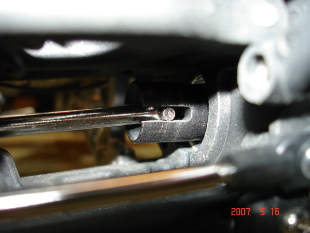

can you please post a pic of how the dogbone is in the drivecup?

me?
Here is mine.

Looks like they could be out a tad further.. hard to tell from that angle though.

I usually put the center of the ball of the dogbone on the point where the angle starts inside the cup. (keep in mind that moving the suspension up and down changes the distance)

So you think it is hitting the back end of the cup then when the arms flex? When the CVD's are straight (under acceleration) the bones are a little bit more than half the way into the cup (center of pin).
I do have the pillow balls all the way in, I should let the out a bit I guess. At the time it happened, I had forgot to grease the out drives on the rear diff, so it had seized up, and was almost like a locked spool. I have a hunch that was it.
